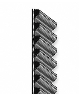

Thank you for your response. Our gearbox will be directly coupled to the motor. The belt will be between the gearbox and the roller. I am pretty ignorant with regard to types of belts as I work in the electrical field more than mechanical, but the belts we used are described as timing belts. I am pretty sure we always use 8 mm pitch in various lengths. A typical part number we use would be "8M-1440-20 HTD TIMING BELT". I have attached an image below...
I will google as you suggested. I am just wondering if you would think this kind of belt would introduce more or less loss that a typical "V-Belt" (if in fact there is a difference between what we use and what you had in mind).

That's a timing belt - has a fairly precise positional relationship between drive and driven pulleys but not desperately efficient. Google 'Poly-Vee' belts for one relatively low-loss belt type.

Timing belts like to run tight.
Consider a strong spring loaded idler near the smaller pulley if you decide on the timing belt.
