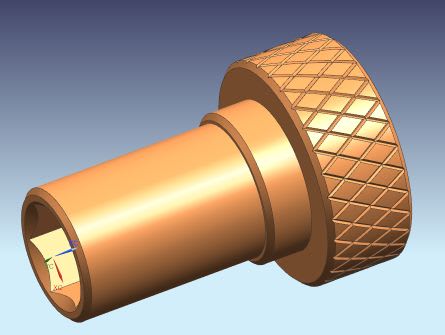

I'm trying to write a Journal that would create a Knurl on any cylindrical face, like shown below, with just a few inputs. Manually I create a plane tangent to the face, sketch a curve, wrap it to face, create another sketch, sweep that sketch with the wrapped curve, mirror sweep and then a circular pattern.
I'm new to Journaling and the code below just creates the first plane tangent to the face. It works when my geometry is relative to absolute but I want it to work relative to WCS. Is there any command to make that happen? I've seen Csys.MapPoint in this forum but seems like I should be able to always work off the WCS.

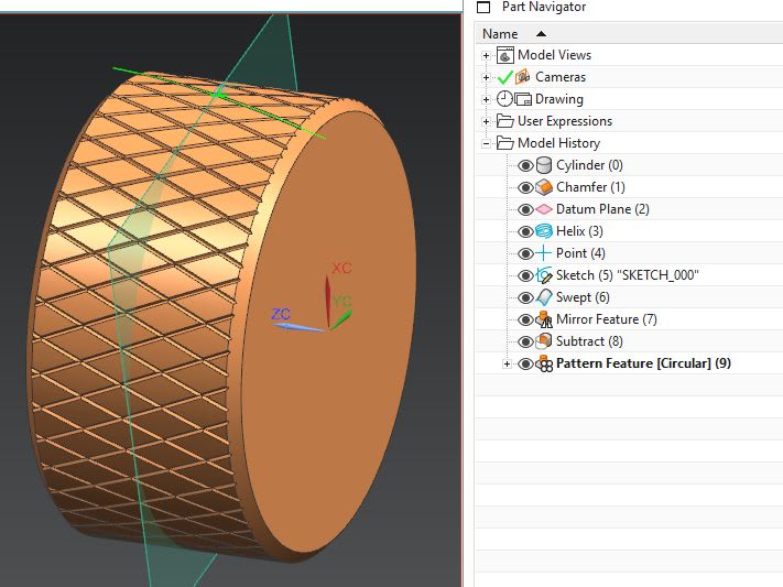

I can't help you with that journal, but i can maybe propose a simpler method than the wrap curve.
Use a helix instead, then you do not need the sketch / datumplane/ wrap.

Thanks Cowski!
Toost
Helix does sound like a better approach... I was also trying to use the thread feature but was unsuccessful.
(Edit)
Helix approach cuts down the feature tree list quite a bit. Not sure if it represents real geometry of a knurling operation but I usually add a note stating geometry shown is for appearance only and call out a specific Knurl.
