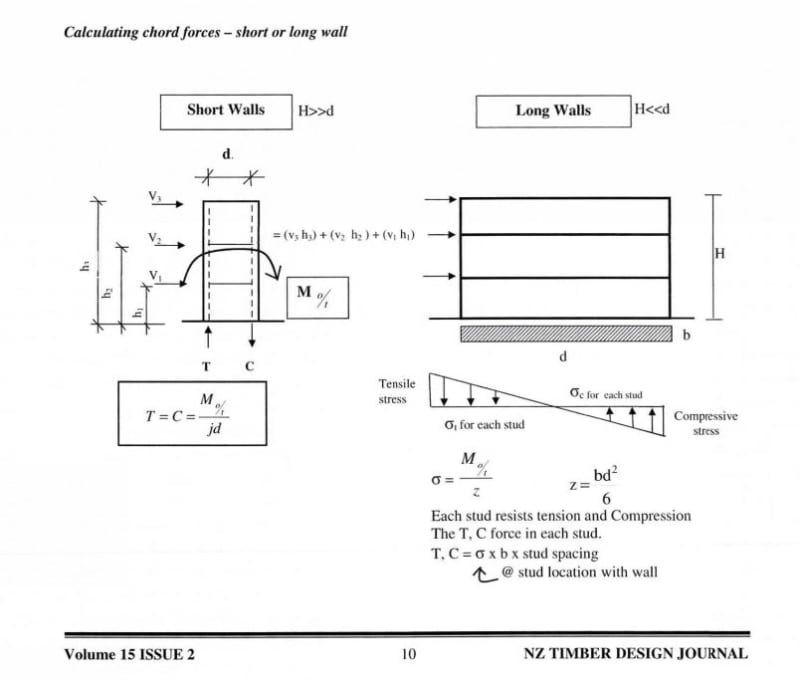

How Do Antipodeans Design Wood Shear Wall Boundary Members?
KootK
Oct 16, 2001
18,690
I hereby summon my antipodean frenemies to this thread to share your thoughts regarding wood shear wall boundary member designs. The OP in that thread referenced the clip below which is rather different from common North American practice.
