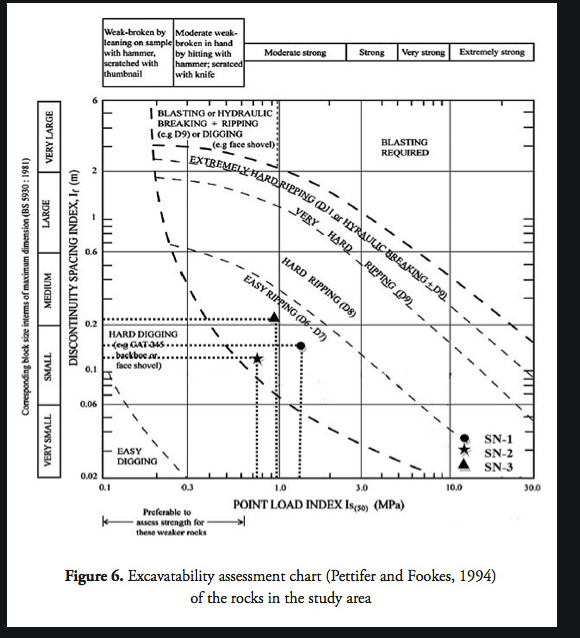

I'm developing a methodology for trenching in a basalt area in preparation for drain laying. Once the final design drops out I'm expecting several kilometers of basalt will have to be removed. My initial investigations have eliminated explosives due to residents and other existing services. Rotary grinders have been discounted as they do not have enough grunt to break up the basalt. So I'm currently looking at breakers on numerous machines.
Does anybody have any experience with getting through basalt or can recommend an attachment or plant that can break up basalt.
1 - Your best bet would be to talk to a local contractor who has experience in trenching through basalt.
2 - Tell us more about the project, how deep is the excavation , what is the rock parameters (RQD, UCS etc.)
3 - The below Peffifer and Fookes 1994 chart can be used as an initial guide. However, I have seen this bee both very conservative and un-conservative so highlight that the contractor should choose their plant appropriate.
The chart provides recommendations for bulldozers with tail rippers. These will work fine if you have a nice and wide excavation, if you have a very thin excavation and are limited with space you may have to cut and chisel.
Basalt like any rock comes in at least a half dozen forms, depending on its hardness, weathering and jointing.
If I needed to trench through several kilometres of the material I would want trial pits excavated every couple hundred meters and, if hard rock is identified as a problem in those pits, a few seismic traverses to use as the basis for a rippability assessment.
In my area, South Africa, the basalt is usually very well-jointed and even the hard rock material can be ripped with a powerful excavator to a fair depth. Every now and then we hit enormous core-stones (kernels) which have to be blasted. In other areas, the basalt is massive hard rock which requires blasting from the onset.
Better to obtain some rock mass parameters before speculating on this...

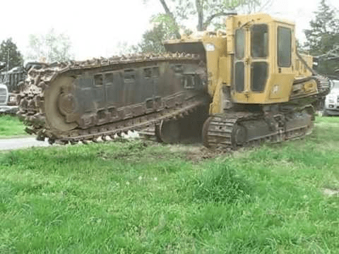

unlikely that a ripper tooth on a bulldozer can excavate a 13 foot deep trench for utilities. on the other hand, the vermeer rock saw trencher pictured above is designed for trenching in rock. it will take plenty of teeth as they wear out quickly in hard rock.
Agree Cvg, as I indicated, nice wide trenches a ripper is fine but if your in a residential area where you want to keep your trenches as narrow as possible, then cutting and chiseling is an option but a slow one. A rock saw as cvg shown would be quicker but probably a lot more expensive.
Youll have to see how both work out with your construction cost and time schedule.
