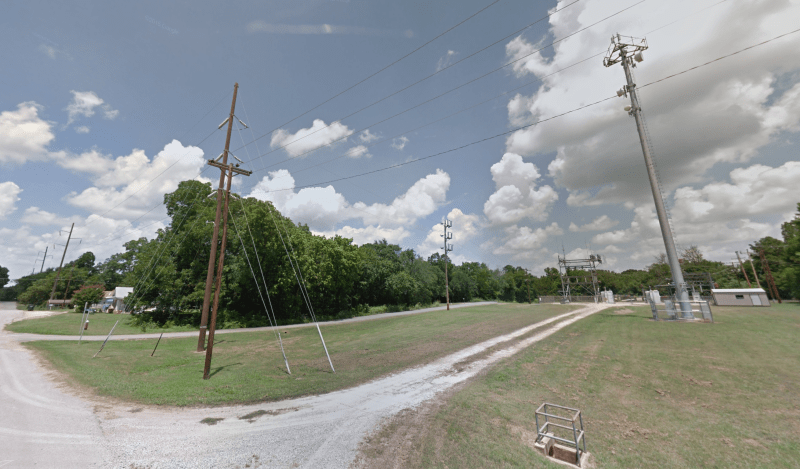

Or where a 230kv line is used for 34kv :P
Bizarre-looking only at first blush; we have numerous instances where we use retired 115 kV circuits as 28 kV feeders.
CR
Yep, happens all the time. Benefits: better clearance, better isolation between phases, and reusing existing infrastructure (less cost).
Can't say I'm not impressed by the 230kV line with the 35kV pole next to the structure, though!
