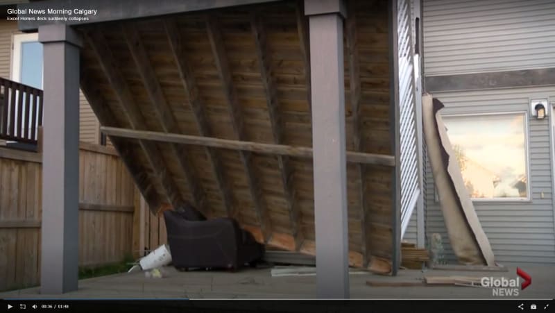

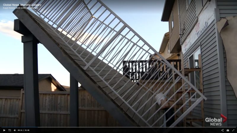

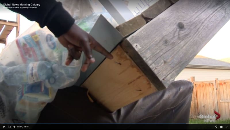

A few screen shots from the video in OPs link.
So by the loos of it a solid single piece deck connected to the building by two 4 inch nails every few feet.
Amazing it lasted as long as it has.
Those nails look a bit puny; my decking nails for top boards look to be thicker than those. They also look barely long enough to get through the sheathing and certainly not enough for getting a good grip on any studs they might have been nailing to.
TTFN (ta ta for now)
Is the builder going to inspect and make good all of the substandard work that they did or will they just force the maimed to sue them? Where is the building dept. holding the builder to account? This is why the construction industry has a bad reputation.
It looks like a single ply header with about 1-inch of nail protruding. I'd say they are 10D 2-1/2" nails. Frightening indeed.
