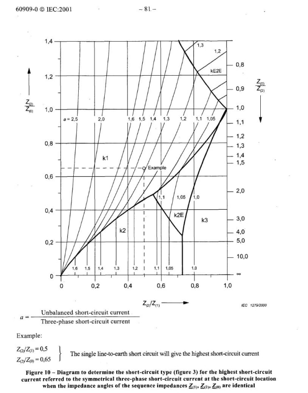

Location in the circuit? If it's near a transformer secondary, the L-G fault will be higher.
See IEC 60909-0/2001:

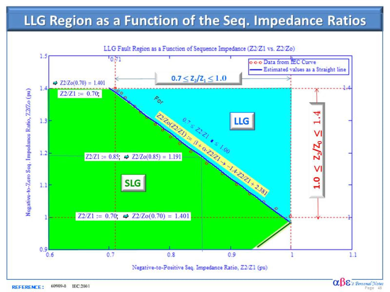

If the transformer is WYE (high side)/ delta (low side)then the a L-L-G fault
current on the WYE side is higher than the L-G fault. Typical example is a WYE/delta
transformer connected to the Utility at small distributed energy resource (DER) stations.
LLG fault is larger than SLG fault if the following conditions are satisfied:
1) 0.7 ≤ Z2/Z1 ≤ 1.0 and 2) 1.0 ≤ Z2/Z0 ≤ 1.4
The graph below indicates a linear approximation of the region were LLG fault is larger than SLG.
