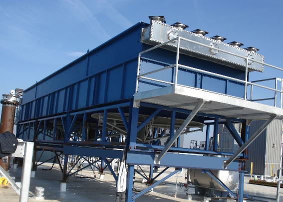

Dear LittleInch,
Thank you for your response.
I am designing a cross flow heat ex-changer(HX) which transfer the heat from sodium to air, sodium on tube side and air on shell side. The heat removal capacity per HX is 20 MW. hence the air flow requirement is very high (80-110 m3/sec). But i don't have lots of space to install This kind of blower, so I am looking for a compact blower which can be accommodate in a 3m2(maximum) space.
Something like this?
Also 3m2 is an area, not a volume.
I would suggest you contact some air cooled HX vendors myself.
