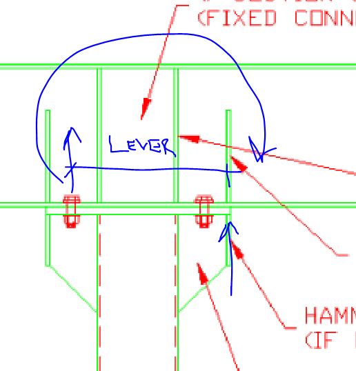

I have an old spreadsheet I am trying to bring into the 20th century. It is for an HSS column that is fixed to a W-Section. What is the latest guide on the design of this connection? The only thing I see after a quick internet search is the second image below. It is for a shear only connection and not a fixed connection. The first image is a generic detail of what I am trying to do and there are portions of it that may not be in every design. Everything else I find on the internet has the W-section framing into the side rather than across the top.
Any help would be appreciated. I am not up to speed on the LRFD methods but it looks like I am going to have to learn them. I am especially looking for the current way of checking the web gusset to the HSS versus a through plate.
Are you married to that connection style? It's pretty bad ass but it's not one that I've ever seen in print. If you want it just this way, you/we might have to feel your way though the load path first principles style.

The gussets and hammerhead flanges are what I have had to use to reinforce an existing splice that appeared incorrectly designed. I do some rehab/repair projects. For that reason, I put the calcs in my spreadsheet for that. I do not think I have ever had to do one as new construction. I have had to add them to a new design I did because the fab people got the plate thickness wrong one time but had already fabbed all the columns and erected them when I noticed the plates looked too thin. We had a standard note about capping all tube and pipe columns with a 1/4" plate UNO and someone took that to mean even the splice plates.
KootK: In your sketch, is Cr at the inside face of the section thickness? I am assuming the distance from Cr to 2T is your moment arm? When I add the gussets and hammerhead, I have to calculate the new NA.

Your issue would then be the tendency of the gusset to push into the HSS walls and yield them in complex ways. The guide below is probably a solid resource but I'm not sure that even it covers your exact situation with respect to the delivery of a localized moment. Baring better info, I'd be inclined to just envision a horizontal strip of HSS wall resisting the inwards thrust and design that to deal the bending. That face could be reinforced as needed. Heck, you could use wide flange chunks in place of the gusset and probably get your reinforcing that way. You know, space and aesthetics permitting.
The middle of that wall would probably be most accurate. But, given the uncertainties involved, I'd not bat one of my luscious eyelashes as using the inside or outside faces of the wall.
Yesir.
A) How do you do that?
B) For what purpose do you do that?
I'd think your moment arm as shown below.

I had not thought of that. I may add that to the spreadsheet too. Probably easier to calculate than the gusset and hammerhead. The gusset and hammerhead is when I have limited splice plate length to deal with. I could notch the W-section chunks around the plate if needed. The added steel shifts the NA, lowers the bolt load and allows the load to be dispersed to multiple locations.

I calculate the NA similar to concrete reinforcing calculations where you have the tensile steel area and the compression block area. The difference is that it is not a rectangular stress block but rather one that follows the footprint of the steel that is in compression. It may take some time to find my original source for the method since I have not looked at it in about 30 years. The spreadsheet I use is protected so I will also have to find my original spreadsheet from the dark ages. As I recall, the method is somewhat similar to some work by Eli Czenrniak. It may take me several days to find the information because we are taking a few days off.
