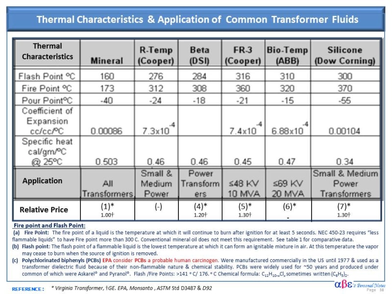

Sep 6, 2019 #1 Mbrooke Electrical Joined Nov 12, 2012 Messages 2,546 Location US Does anyone have any documentation of the flammability of various types of transformer fluids (FR3, Askarel, ect) and at what temperature they will ignite? Interested in regards to transformer fires.

Sep 6, 2019 2 #2 cuky2000 Electrical Joined Aug 18, 2001 Messages 2,135 Location DO Below is a partial list of thermal characteristics of common transformer fluids used in the industry. Hope this helps. Upvote 0 Downvote

Sep 6, 2019 Thread starter #3 Mbrooke Electrical Joined Nov 12, 2012 Messages 2,546 Location US Helps? That would be an under statement! Upvote 0 Downvote
