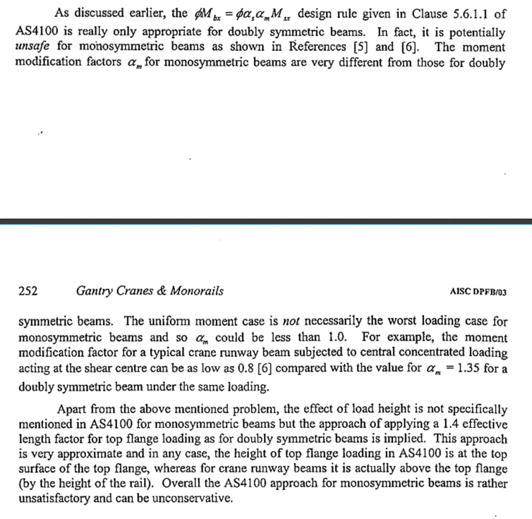

You are probably correct. This is from the Australian AISC (now ASI) 'Design of Portal Frame Buildings'. It doesn't address the kt factor but the conclusion is pretty damning even without looking at the Le calculation in detail. It goes on to propose alternative design rules for monosymmetric crane beams but they only cover simply-supported beams at a quick glance.
I have come across that in the past when doing some work on crane runway beams. Totally agree that unless you have an alpha_m that is in table 5.6.2 then you need to do a buckling analysis to determine the alpha_m for your unique loading diagram. But I am not sure if they are saying the whole procedure including use of M_o eqn with beta_x is flawed or not even if your moment diagram shape is in table 5.6.2.

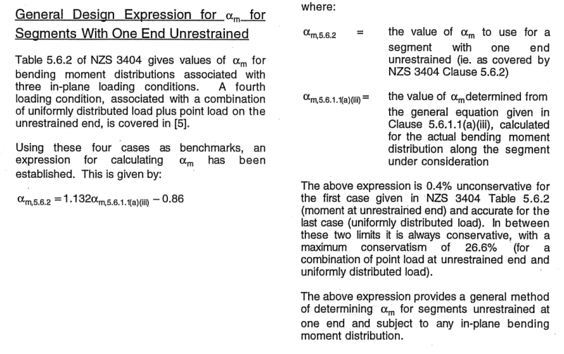

Someone here in NZ actually did a curve fitting exercise and came up with the following relationship for alpha_m for a segment unrestrained at the end. It's used in some local software for checking steel members. Might be an interesting exercise to see if it is actually in agreement with a buckling analysis. I've looked at it in the past with regard to a few known other moment diagrams and it did a pretty good comparison. But the person who did it may have only used the same known relationships to curve fit the equation, and it may not represent points between that well.
