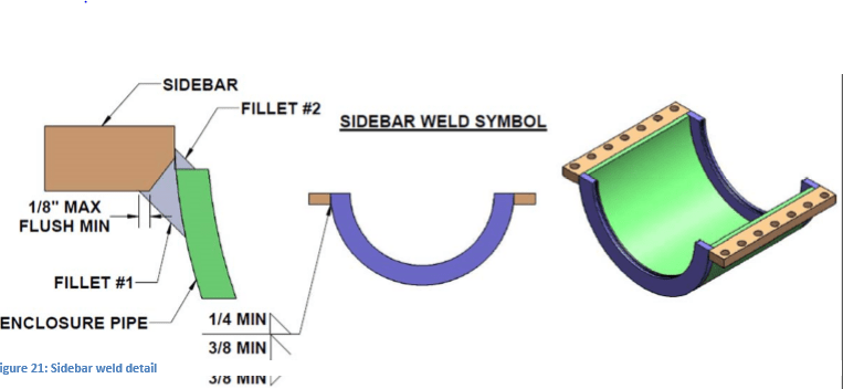

Im needing help with developing some calculations for bending and shear stress. The weld will consist of a partial bevel and a fillet (fillet #2) which joins a piece of flat bar to a piece of pipe. See the picture. This will be used for a bolt-on pressure retaining clamp. Our current calculation method is shown below but I believe it is very conservative. Thanks in advance.
Shear stress = Force / (length of weld) x (Fillet size)
Bending stress = [3 X Force X (pipe wall thickness)] / (Length of weld) X (weld thickness)
Assuming the force is due to bolts in those holes-
Assuming the two halves don't touch on the flange face when the bolts are tightened-

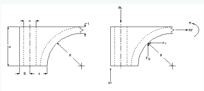

Thanks for the reply. I have other calculations that analyze the stresses in the enclosure pipe and flat bar. I have come across the imagine below for welding I-beams but I'm not sure its the same with my weld configuration.
My concern is making sure the welds are sized correctly.
Those don't appear to have anything to do with what you are doing.

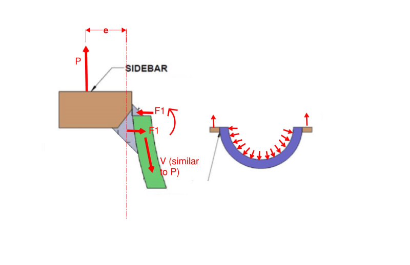

Your weld is experiencing a moment about an axis parallel to the pipe itself so you will have a force couple between your two welds from the eccentricity between your bolt force and the pipe weld centroid.

4. Do you agree with the picture and formula below for setting up my force on the weld? I know this is no representative of the pipe assembly but the idea is the same.
P = internal pressure from cavity
A = edge of flat bar to bolt CL
B = cavity to bolt CL
W = shell wall.
Force on weld = P x [A + B - (W/2)] / 2
I think you are confused here. There is no bending in the weld lines along the pipe/bar interface. They are taking direct shear perpendicular to the weld axis and they are taking direct coupling forces perpendicular to the axis as well. Using weld moments of inertia imply that there is bending in the welds resulting in variable stress in the welds along their lines. I don't see that - it is simply a direct, but eccentric, force across the the weld line presenting a uniform stress along the line.

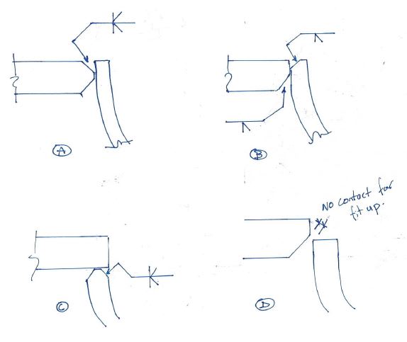

I don't like your weld detail here. The way you have it drawn, there is no contact for fit-up - you would need backing bar to start your fillet weld. In addition, your weld is heavily unbalanced, and weld distortion could be a problem. What is the scale of this thing, how thick are the plates? I'd prefer options A, B, or C shown below.
As far as the weld design goes, I agree with JAE's approach.
