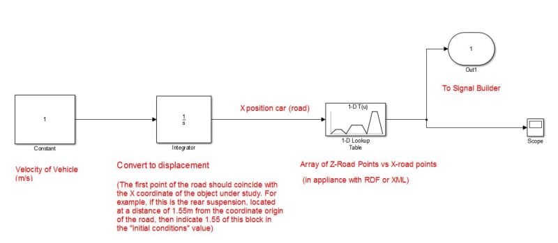

Maybe such a scheme in Мatlab will help you achieve what you want.
RE: Adams/car Road Numeric Series of Values ... where are they ?
so what do I have to do?
does this mean that i should link adams and MATLAB for getting the height of the ground elevation for the road file ????
is this really going to be that hard ?
i thought that this is only a matter of getting road data from an adams file spreadsheet or something ? ( i mean from the post processor )
isn't there a way to get the road data file from postprocessor ??? how does a simulink code like this would help me get road data from Adams/car ????

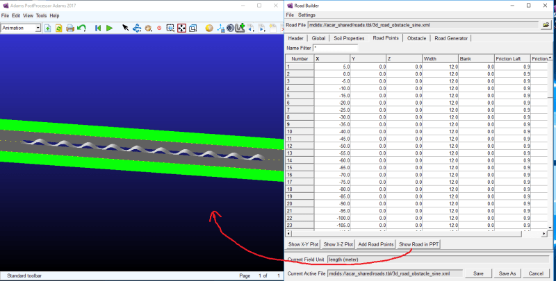

Can you post the name of your road xml file here? or ideally the whole thing. Normally the xml is just a container that points to a text file (typically .rdf) that has a very obvious structure.

hi Greglocock
sorry for replying so late … thanks for getting into it
the name of the xml file is :
3d_road_obstacle_sine
when I open the xml file the other coordinates ( other than x direction ) are zero 0 . so they don't change …
how is it possible in a sine wave obstacle … when I know for a fact that I have added a sine obstacle to my road with certain aspects and I can see that in the results ...

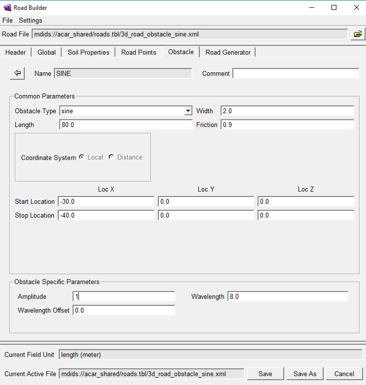

The Road Points tab contains points for an unobstructed road. Obstacle type formation is carried out in the Obstacle tab. For example:
