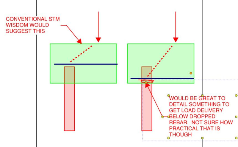

It is a massively important, yet somehow little publicized, tenett of concrete design that loads and reactions are to be delivered on opposite sides of the member. And, by implication, loads and reactions should be outside of the flexural reinforcing. If your pile reactions are delivered near the tops of the piles, and you drop the rebar low, you will be in violation of this. That doesn't mean that the bars can't be dropped below the level of the pile reactions but it does mean that some careful consideration must be given to the punching shear issue that the other guys have mentioned above.
OP said:
do I need to consider a strut and tie model?
Meh. Given the proportions of most pile caps, it's pretty hard to argue that they all shouldn't be done with STM. That said, STM is time consuming and I mostly still see these things getting designed via sectional methods or semi-sectional methods as with the CRSI stuff. That said, if you were to do the STM, I think that you'd arrive at something similar to what I've shown below and that would get you wondering about placing the bars at the bottom of the cap. More complex models can be developed to make a go of things with the rebar low but you've pretty much got to sort those out yourself as you aren't likely to find them anywhere in print.
Some additional thoughts:
1) It would be great if you could move the pile axial reactions down to the bottom of the cap somehow as I've shown below. I'm not sure how practical of a solution this is though.

KootK: I know almost enough about strut and tie to be dangerous, but am not well-versed. Every S&T model I've seen is delivering a point load similar to a truss, with the struts & ties acting like truss members. Can S&T be used for beams that have a uniform distributed load? That's more similar to what I'm dealing with. Please see my note below.

I didn't say that you couldn't put your bars low. What I'm saying, is that if you have real grade beam loads that need to get over to the piles and you do put your bars low, you'd better have one well though out answer to the failure mode shown below. Otherwise, you're going to be one super-sorry-chieftain. This comes up all the time in my neck of the woods with grade beams on screw piles. The nature of screw piles is that their usually capped well above the bottom steel of the grade beam.

Basically what Kootk said (especially his last sketch was exactly what I was thinking & what I was getting at with my comment). Reliance alone on punching shear capacity when you aren't wholey applying the load to the member in a traditional way to the compresison face requires a bit more thought. A strut and tie model of the load acting upwards at the top of the pile leads you to what reinforcement resists this in tension to engage the bottom bars.
Often in standards there are requirements for example where a load is introduced at the bottom of a beam (say from another beam supported perpendicular) in the tension region that you need sufficient 'hanger' reinforcement within the width of the incoming beam and some proportion of the depth either side to drag the incoming reaction up to the compression face, kind of like your situation (the additional stirrups Kootk noted act as hanger reinforcement). Often in these regions you need a few more concentrated stirrups or similar to deal with the reaction and get it into the normal strut and tie truss for the supporting beam.
If I may ask, why do you need a fixed head for a silo? I would expect predominantly vertical loads from overturning and dead load, with comparatively smaller base shears. If you have a reasonable base shear, is there uplift?
I'd consider what's most critical. You want to deliver moment deep into your section, you want to deliver compression to the bottom, you want to deliver tension near the top. They're a little bit conflicting. You can start welding bearing plates or rebar to things to help push stuff around, but that's obviously never ideal from a constructability standpoint.
