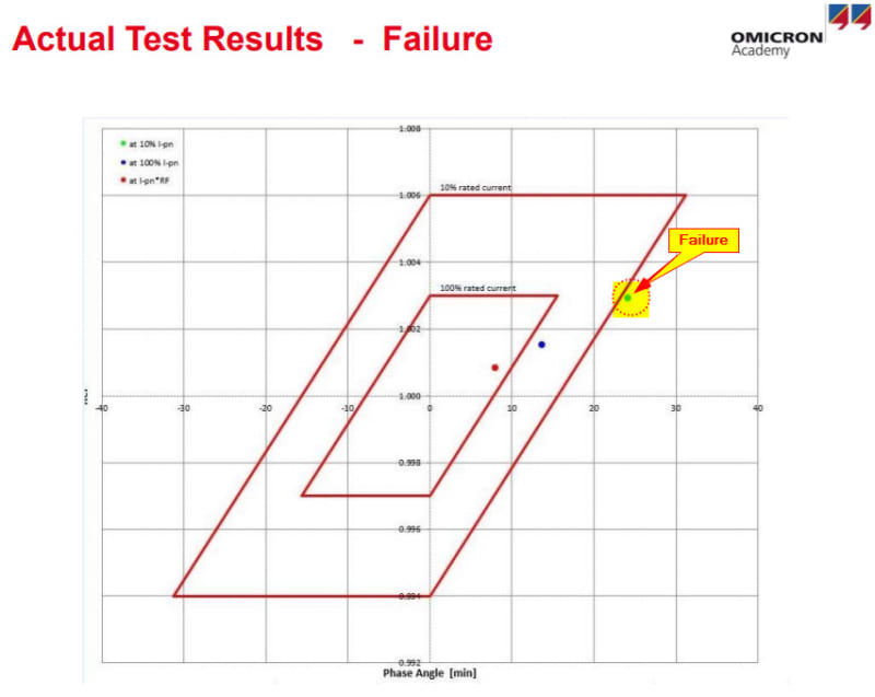

I have a project to update power metering in a building. The existing CT's and PT's are 0.3% and would meet project requirements for accuracy but they are over 30 year old. In your opinion do CT's and PT's accuracy degrade over time. Thanks
The IEEE Std C57.13 provide guidance to test instrument transformer for performance measurement and accuracy. A dielectric test such as the dissipation factor is available. It provides a diagnostic of an aging process taking place (moisture ingress, partial discharge, etc).
After 30 years in service most likely the Instrument transformer are in the wear-out region of the typical bathtub reliability curve were the risk of failure rate increase continuously. compromising system reliability.
Few strategies have been used to mitigate the risk of failure of re-using an old unit. Often ordering spare unit is only justifiable if the cost and consequences of a power failure can be tolerated. Otherwise, replacing 30 years old equipment may be a reasonable option.

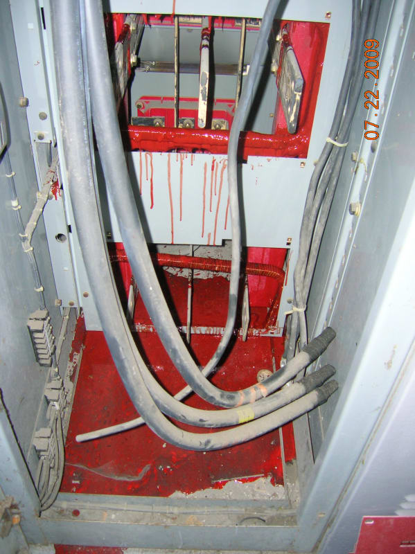

Below is a sample of a CT failure after testing.
I would expect that the insulation - both solid and paper has degradation issues. What is the company's standards for when they take these kind of transformers out of service?
We have found several older ABB/ITE CT's completely break down under normal conditions, summer heat but still normal
Thermoplastics that melt are rarely used in electrical areas where heat can be high. This is probably a case where some thermoset plastic was not properly catalyzed and therefore never fully hardened. I've come across that a couple times in my life.
