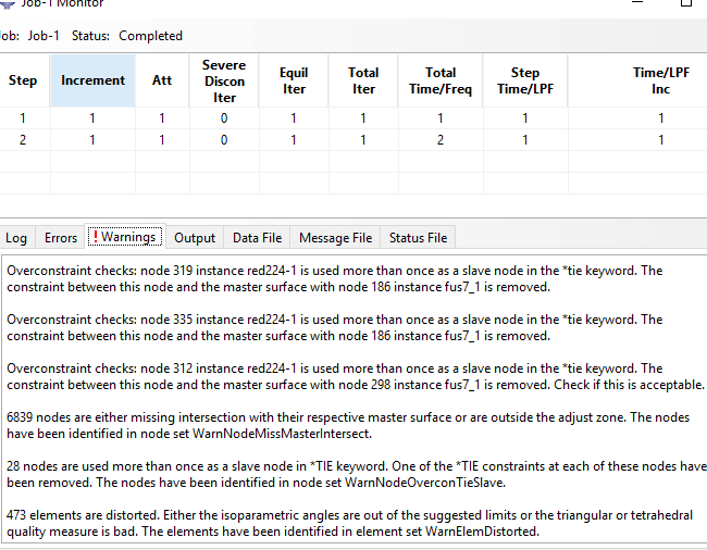

I defined surface to surface interactions between bones again. Now 8 unconnected regions are left and job gets aborted due to same convergence errors.How can I view these regions?Attached are warnings coming now.

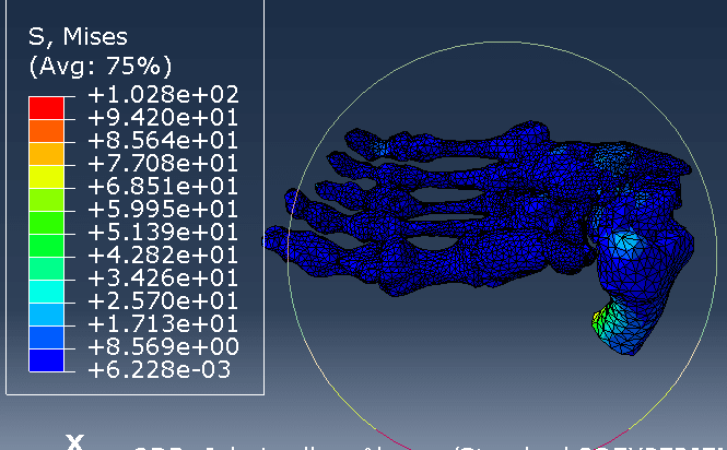

I tried to simulate same model by using tie constraint between bones and my job gets completed but pressure is not distributing properly and most of papers are using surf to surf interactions btw bones.

To see these unconnected regions follow procedure mentioned in my previous post - run datacheck analysis from command line adding unconnected_regions=yes. Abaqus will create sets containing elements and nodes in these regions. However keep in mind that some of the reported unconnected regions are correct. For example when initially open contact is defined between the surfaces and it doesn't close during the simulation because the deformation is low enough to keep these surfaces away from each other. Modal analysis will also be very helpful to visualize unconnected components but all contacts must be switched to tie in this case. Zero pivot error indicates that some parts are not properly connected and they experience rigid body motions.
Can you attach a picture with results from the completed analysis ?
Complete results pics
Check the set WarnNodeMissMasterIntersect. It will show you which regions are too far for interaction to join them with specific adjustmenr tolerance. You may have to increase this parameter but be careful - too high tolerance will force connections between nodes that shouldn't be joined and thus lead to severily distorted elements (even to the point that "zero or negative mass" error appears). You may have to connect some bones with couplings or connector elements if they are far from each other. And maybe general contact will work better. You can test it in Explicit since its formulation works best with this solver.

6) Definitely check "WarnNodeMissMasterIntersect" set. And make sure that you apply BCs only to the reference points of rigid bodies, not to their elements' nodes. What's more it's rather unusual that only 1 node was adjusted, check this set and find out whether the connection was properly established. For the remaining warnings - take a closer look at all tie definitions to see if there are no unnecessary or missing ones.
There are two ways in Abaqus to handle initial overclosures: strain-free adjustments (activated in Slave Adjustment tab of Edit Interaction, mentioned in my previous post) and interference fits (used in case of intended overlaps that should be adjusted with strain generation in Abaqus, not adequate in this analysis). However for significant overclosures I wouldn’t rely on these algorithms (even if you specify appropriate tolerance for strain-free adjustment) and I would reposition instances manually using tools available in the Assembly module (Translate Instance, Rotate Instance, Translate To and so on).
Tie constraint’s options don’t include adjustment for overclosures but you can use tied contact instead of tie (add contact pair and select „Tie adjusted surfaces” in the Slave Adjustment tab of Edit Interaction window).
Overconstraints generate warnings only if they are consistent. In case of inconsistent (conflicting) constraints the analysis would be stopped with an error. Abaqus tries to resolve those consistent overconstraints as indicated in the error message. Thus the only thing that user has to do is to make sure that they were properly resolved. Probably there’s nothing to worry about in this case but as I said before examine all tie and contact definitions carefully as well as analyze odb file to see which nodes were adjusted, which were connected and which failed to connect (use sets generated in the analysis and display group options).

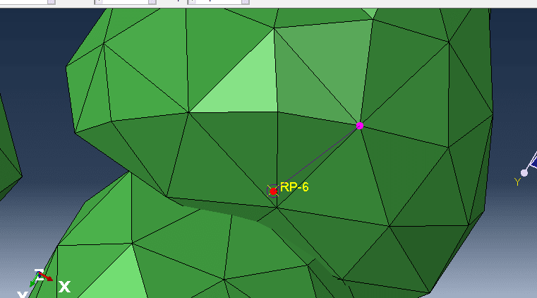

1) I made one reference point in between phallange & metatarsal and second reference point on calcaneous foot(normal foot).Attached truss element(plantar fascia) between these two reference points. In order to couple these truss elements with foot nodes I first tried to use truss element end node as control point and reference point on foot as slave but was getting errors of can't using coinciding 1 node as slave and control point in kinematic coupling...Hence I took truss element end node as control point and a separate node on foot for coupling...Pic is attached...Did this for coupling both truss elements end nodes at calcaneous and in between phallange & metatarsal...Am I coupling them in right way??

It should be done this way:
- there are two RP’s between the parts, as you said
- truss or connector is placed between these RP’s (has ends attached to them)
- each RP has kinematic coupling assigned; these kinematic couplings are connected to the nodes of corresponding 3D part (but single node is not a good idea, better attach it to multiple nodes)
All tendons can be modeled this way.
