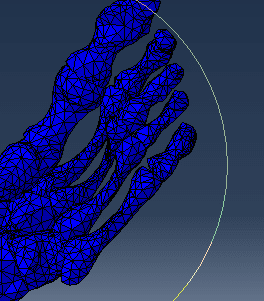

I am modelling neuropathic foot bones. I have segmented 19 bones via MIMICS software. For meshing I used MATIC and Hypermesh. Now I am trying to simulate the neutral standing position of foot with Abaqus/Implicit (Quasi Static).I considered bones to be elastic and giving material (Young's Modulus=7300, poisson's ratio=0.3, density=4.49e-10) to each bone.I fixed the upper surface of tibia and giving concentrated force of 350N from below the ground.
I want to have a surface to surface contact between bones (finite sliding, frictionless) and between foot and ground (hard contact,finite sliding,penalty 0.6) but due to convergence error job get aborted.I tried changing increment in step and through solver control but still getting increment errors.In warnings I am getting some unconnected regions but as its a neuropathic foot it have some bones eroded. I am stuck in this for several days and can't figure out problem in my project. Kindly can someone guide me what I am doing wrong.
Below are some pics of model and warnings.
I want to kinematic couple my calcaneal bone with a point reference point but getting errors...giving achilles concentrated force on that reference point

That's rather unusual. Carefully check all units. If they are correct then maybe the analysis experiences instabilities that occur when parts in contact are stiff. One idea is that there are some rigid body motions that don't appear when material is flexible enough to deform in such way that contact between the parts is closed and they are not experiencing rigid body motions anymore.

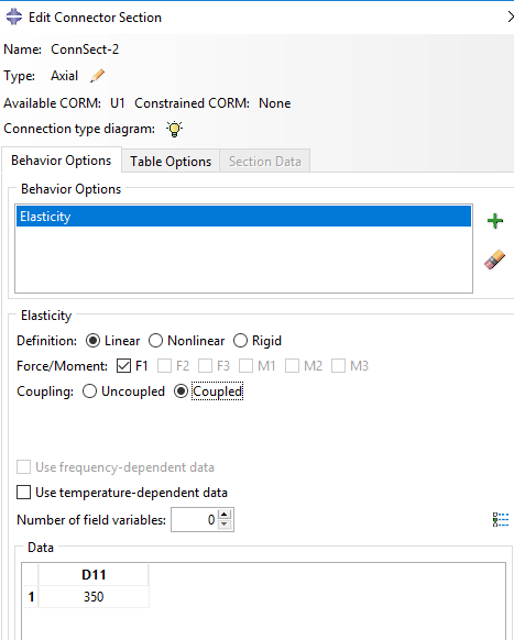

Well job is completing now...But one thing i realized in animate scale factor that Plantar fascia truss elements are not connecting properly to calcaneus..I did same as you suggested..Made a reference point at end of truss element and couple that RP to some nodes of calcaneus..There is no warning of unconnected regions and job is completing but truss elements are not connecting properly
Is it unconnected all the time or separates at some point of the analysis ? Did you try with connectors instead of truss element ? They are meant to be used in such cases and you can choose from various types as well as include damage criteria and connector stop option.
They disconnect in middle of analysis...I have used axial connectors and couple them to phalanges and calcaneus..But foot bones move to a side while remaining in contact..Is this due to BCs or I am doing something wrong in connectors?
Keep in mind that axial connectors, as well as truss elements, normally can't take lateral loads. You would have to apply pretension to them first (or specify other directions in case of connectors).
