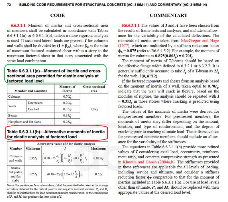

I'd disagree in part with what Kootk has said, if you're dealing with a reinforced concrete structure the ACI stiffness reductions are about directly accounting for the effect of the reduction in the stiffness of your members once they are have cracked. So if your design actions are greater than the cracking moment (which is almost always the case for a well proportioned structure) then you should consider the stiffness reductions for both strength and global lateral drift checks.
Pretty sure ACI says this type of thing explicitly, that any modelling should take account of the degree of cracking expected at that limit state.

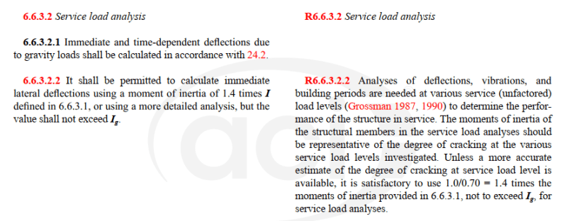

how much we reduce for ULS and Drift Check? Or follow Code?

Okay, so the ACI reference was NOT a mistake.... So, yes you adjust your member stiffness per ACI.
Either method works. I usually just use the (a) values. We're really trying to linear-ize a non-linear behavior in a way that provides acceptable analysis. Using method (b) is more complex and involves evaluating the moment of inertia under a number of different load combinations. Then you'd have to re-iterate your analysis to see if the forces changes enough to alter the moment of inertia further.
