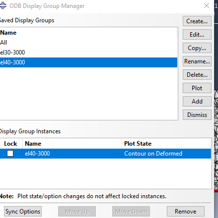

Hello,
I would like to isolate elements above or below certain stress/strain levels. This was easy to do in Hypermesh, where you can use a slider that controls which elements are seen by revealing clusters of elements based on the slider position. Is this possible in Abaqus 2018? I found section cutting but nothing like what I described. Thanks

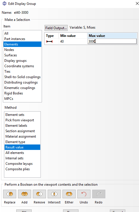

Yes, you can create a display group based on the range of values of selected output variable: Create Display Group --> Elements --> Result value.
@FEA way, thanks so much. However, I tried doing this and clicking plot, but none of the elements are changing in view after I press plot.
In the first window click Replace button. This way elements with stress between 40 and 3000 will be isolated from the rest. Unless all elements are in this range ...
This worked!
Thanks so much.
