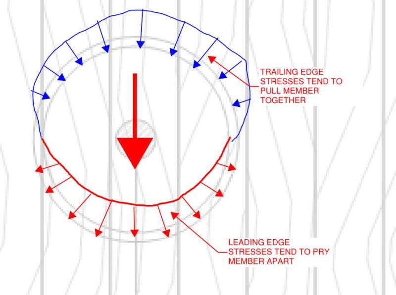

Do you disagree that they do both but, hopefully, in relative net balance over a single connector? It seem pretty apparent to me, based on the geometry, that the leading edge would push the wood apart and the trailing pull it together. And nothing about the grooved slot changes that for me. For hyperbole, just imagine the thing shaped like a diamond rather than a circle.

Alas, though, all I see in the video is that these things are steel rings inserted into routed slots. None of that changes my opinion of the state of stress which is shown below. Fundamentally, I see a split ring as being a version of a dowel fastener. And, like all dowel fasteners, it induces lateral stresses in the parent material when loaded laterally. Owing to the fact that split rings are annular rather than solid, you accrue the nice benefit that the net lateral stress integrated over the entire connection is zero. Well, it's surely not exactly zero but good enough.

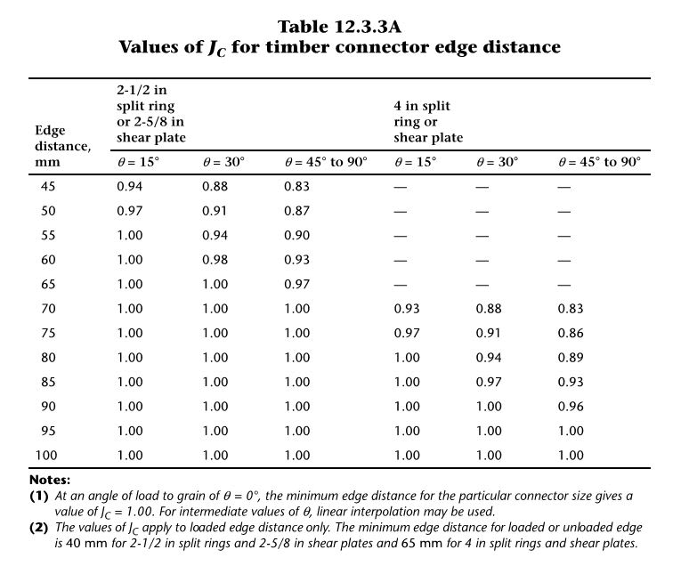

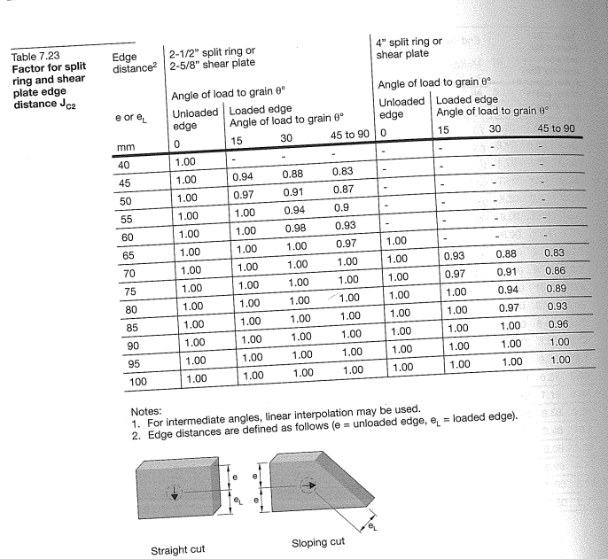

I do not have the CSA 086 code or text which you are looking at, so I don’t know exactly how to interpret your "J" factors
For your viewing pleasure. Just as you're thinking: Canadian edge distance factors.

In your mind, is the split eliminating the potential for the development of lateral stresses somehow? As I see it:
1) There would be some of this effect but not much since, even split, the ring's going to be pretty stiff compared to the wood.
2) The reduction in lateral stresses would be very much dependent on where the split winds up being relative to the orientation of the load. A split aligned with the load might do something but I'd think that a split located on the sides would do next to nothing to alleviate lateral stresses.
