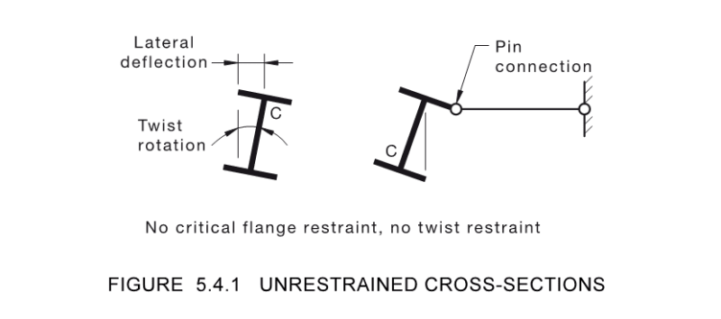

If you think of it like this, if you put a 'L' restraint to the tension flange of a simply supported beam, then it does nothing for the compression flange (see figure below from the AS4100 code) I hope you would agree? i.e. a 'U' restraint (EDIT - as far as the critical flange is concerned)!
This is the exact condition at the end of the cantilever isn't it if you only laterally restrain the tension flange? So I believe it covers the requirement in AS4100, its just not spelt out clearly/specifically like it is in NZS3404 so perhaps people don't pick up on it over the ditch in Aussie? Does that satisfy you?
Agreed.
