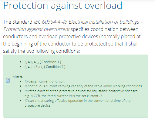

O.K. Juan you explain us how to calculate Iz according to IEC 60364-5-52 for low voltage. For medium voltage I think IEC 60502-2 Annex B is indicate [however, informative only].
What about Ib and In? As far as I know IEC 60364-4-41 does not deal with overload but only with short-circuit currents.
In IEC 60972-2 only Ir [Adjustable overload setting current] is stated [it could be close to In?] and Ir*1.3 as Conventional tripping current [I2?].

Yes, I gave an incomplete list in my previous post. The IEC 60364-4 consists from: Section 41: Protection against electric shock; Section 42: Protection against thermal effects; Section 43: Protection against overcurrent.
The link Link says it is mentioned in IEC-60364-4-43.
Is there any relation between the nominal rating of the protective device and the selection of cable in NEC? Yes, I'm talking about the small/temporary overloads which exceeds the nominal rating of the protective device.
However, when I see the examples of cable sizing done as per IEC (Previously done by others/from internet), the conditions mentioned above in IEC 60364-4-43 are not followed but I could see these conditions are followed in the cable sizing done as per BS 7671.
I wonder if these conditions are indeed mentioned in IEC 60364-4-43, why is it not followed? (I have seen dozens of examples of cable sizing done by others as per IEC, but none used these conditions)
