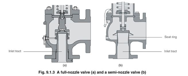

As there are 2 type of nozzle for PSV i.e. full nozzle and semi-nozzle.
While the semi-nozzle design will exposed the valve body to inlet pressure (high pressure), can we still apply HT pressure of 1.5 x Outlet Design Rating for the body? The same also applies to pilot type PSV where it does not have a nozzle at the inlet, thus the body is subjected to the higher inlet pressure.

The first picture is the two spring operated design SRV's. I have covered the full nozzle in the earlier reply.
The other "Semi-Nozzle" design is effectively a non ASME/API design, though you can obtain ASME VIII "UV/NB" certification. These semi-nozzle valve types are more of a European DIN/TUV supply. They are also limied to lower pressure classes. I don't have too much information on the testing of the semi-nozzle design, but would believe that some form of hydro is performed with the nozzle seating area blocked off. This to also test the integrity of the weld of the nozzle to body internally (sometimes this design has the nozzle scrwed in or swaged in by force). The same principle, as before, using the body outlet rating would apply for the body bowl(shell) testing. You would need to contact the specific manufacturer on this since there a few varying designs of his set up.
The pilot operated SRV design depicted may have an inlet hydro done in a similar fashion as the semi nozzle spring operated SRV. Again, different manufacturers have different set ups. In this case the sensing tube and seating would need blanking off for hydro test. Full inlet rating applies to all pilot operated SRV sizes.
For the body bowl (shell), the outlet method is used again. For these designs. the outlet is fully rated for all sizes (D to T orifice).
