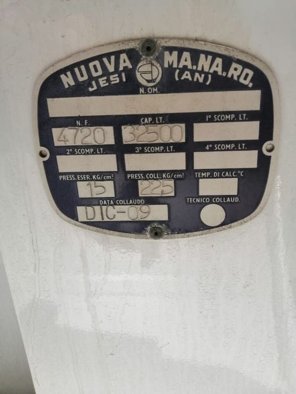

i own ammonia tank in egypt 32500 liters one compartement made of P460nj2 according to ASME built by nuova manaro italy but company closed
i got crack near dead welding area
i need to fix it but i can not found any data for tank (welding wire should be used and procedures )
tank S.R : NF 4720
is there any yaw to find pressure vessels documentations

Have you checked the NoBo option?
what is the NoBo ??????
can you explain please.
See my 1st post; its an abbreviation of a Notified Body. Is the vessel under consideration CE-marked acc. PED 2014/68/EU? Can you share a copy of the nameplate?
is it that document can be helpful ?
Mmm, too litlle in there to help you on any leads.
