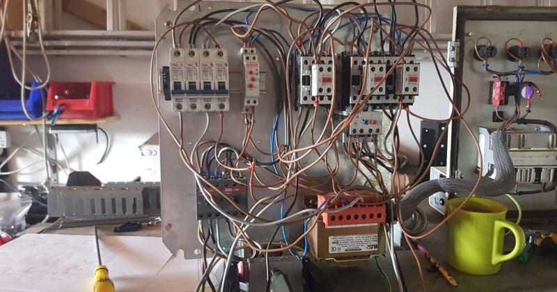

Need some backed-out pictures. We need more of the panel to flesh-out it's particular style.
And what's the VFD got to do with anything?

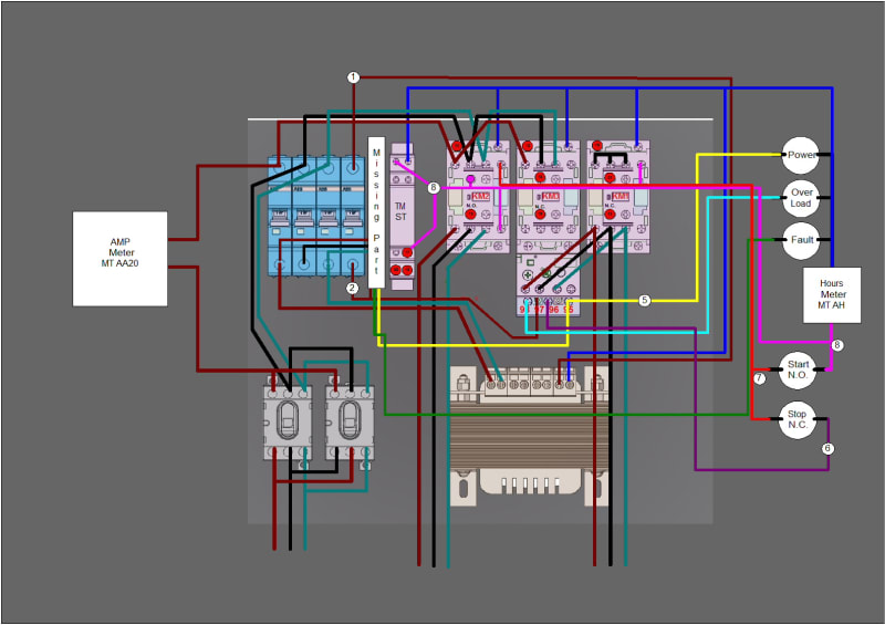

I am in the process of creating a diagrame.
It was a lot tidier until i took out the cable management bars.
is this image any use, most photos i took are close up.
That helped.
Looks like those three contactors on the right make up a star-delta starter. S/D starters require a timer or two.
See if the wires appear to mach up with this:
The timer for it is that device to the right of the blank spot.
I'd say what's missing is another breaker. They also get grabbed more than about anything else in there. Why is this system removed? What are you planning to use it for?

Yes, the diagram you posted is identicle, I am in the process to draw it now.
I suspect the missing part was a second timer.
Might have been a timer to blink the fault light.
You said this was a pump panel. Why would it have had reversing?? That is exactly how those switches are wired.
Are there no operators from the front panel? I'm suspecting not as I don't think you can fit the operators that close together. If there aren't then the switches were probably set up to one-time correct the pump direction of rotation.

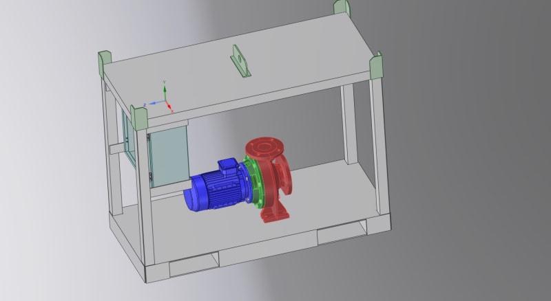

Is this a portable or a relocatable pump skid?

Finally the missing part has been identified which also makes sence of the phase reversal switch.
If the phases are incorrect, this phase monitoring relay will not allow the system to power up and as connected would enable the fault LED.
The operator can then changed the ABB switch to the correct phase combo and the fault led would go off.
Smart actually.

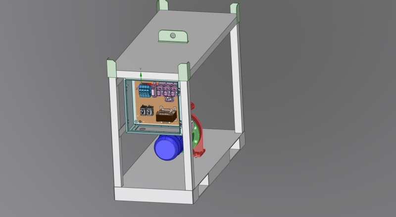

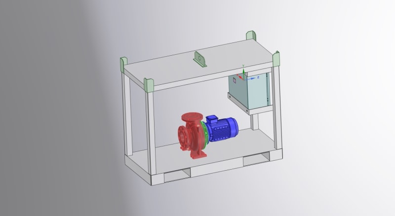

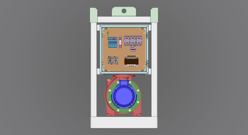

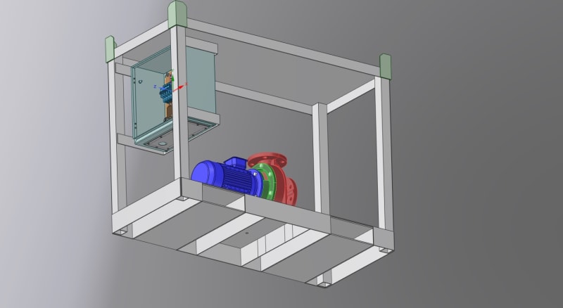

Yes, it is in a transport frame, a big but portable pump assembly. Well maybe not so big as you guys deal with, this is an 11KW motor driven unit.
I will upload some cad drawings i created of it.
