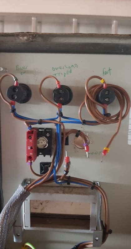

Hello chaps,
I have a water pump attached to an 11Kw 3 Phase motor ( Tested with a VFD and works ok )
Attached to the frame of the pump assembly is a panel containing the following:

In the door are:
3 x Led Indicators ( Power On, Fault, Overload Tripped )
that are :
1 x TMA-AD22-TW-230 230V Led Indicator
2 x TMA-AD22-R-230 230V Led Indicators
1 x MT AA20 Analog 20 Amp Meter
1 x MT AH 230 Hour Meter
1 x E-Stop switch
1 x Missing start switch.
Q1. Anyone recognise this kit list and have an idea what the missing part could be.
One of the cables at the missing part has a tagged (4) which goes to the Fault Led on the door panel.

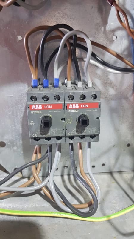

Q2. Also the ABB switches look a little oddly connected up and if both were switched on the phases would short out, Any idea why that is?

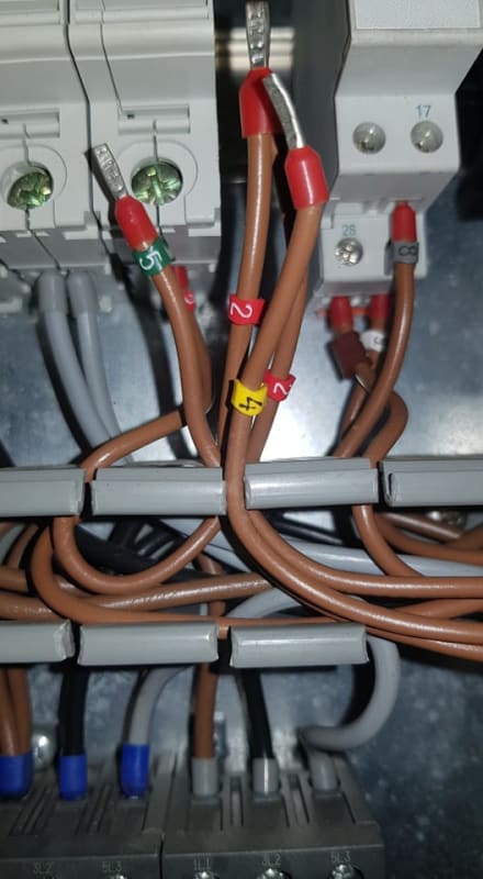

Need some backed-out pictures. We need more of the panel to flesh-out it's particular style.
And what's the VFD got to do with anything?

Hi Kieth,
I am in the process of creating a diagrame.
It was a lot tidier until i took out the cable management bars.
is this image any use, most photos i took are close up.
That helped.

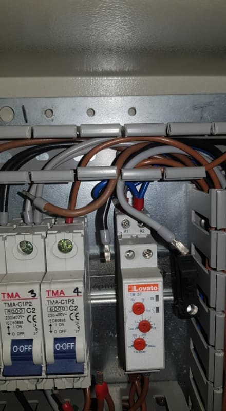

Looks like those three contactors on the right make up a star-delta starter. S/D starters require a timer or two.
See if the wires appear to mach up with this:
The timer for it is that device to the right of the blank spot.
I'd say what's missing is another breaker. They also get grabbed more than about anything else in there. Why is this system removed? What are you planning to use it for?
Scratching my head on those ABB switches. Where's their actuators? What do they look like. Are they mechanically interlocked?

Hi Keith,
The ABB switches have no mechanical connection to prevent both being turned on the same time and blowing the wires.
I read that this is used to reverse a motor, I would never need to do that so I most likely will remove one.
Yes, the diagram you posted is identicle, I am in the process to draw it now.
I suspect the missing part was a second timer.
Might have been a timer to blink the fault light.
You said this was a pump panel. Why would it have had reversing?? That is exactly how those switches are wired.
Are there no operators from the front panel? I'm suspecting not as I don't think you can fit the operators that close together. If there aren't then the switches were probably set up to one-time correct the pump direction of rotation.

Yes it is for a pump, I am not even sure if the pump would work in revearse, it is indeed bizzare. I will most likely remove the extra switch connections for safety and keep it in place as a spare.
Likely what I will do is re-wire it in a more conventional way, more according with the images you kindly uploaded, at least then all the details will be known, Not much would change actually.

Finally the missing part has been identified which also makes sence of the phase reversal switch.
If the phases are incorrect, this phase monitoring relay will not allow the system to power up and as connected would enable the fault LED.
The operator can then changed the ABB switch to the correct phase combo and the fault led would go off.
Smart actually.

Those contactors should have a mechanical interlock of some sort.
If not, consider replacing then with an interlocked device.
Or.-
Consider retaining one of the disconnect switches and adding an interlocked set of contactors controlled by your phase rotation relay.
