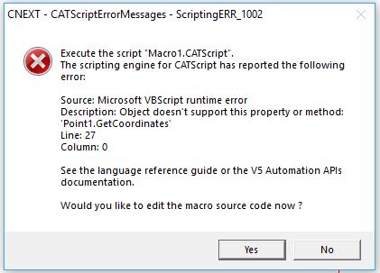

Hi Tesak,
error is attached.
Thnaks,
Sriram
It seems that variable Point1 is not a Point object. In order to find what object is behind Point1 variable please add this line into your code:
Code:
MsgBox TypeName(Point1)
and insert it behind the line:
Code:
Set Point1 = pointSel.Item(i).Value
Let me know what do you see in the message box.
Tesak
- Play Tetris in CATIA V5 drawing
Hi Tesak,
This is message.
Thnaks,
Sriram

I think it is a kind of bug in CATIA and it seems that you can not handle generated items of the view like lines, curves, points properly by VBA. If you try to approach them from inside VBA, you get a DrawingView object.
However, if you isolate the view & change your search query to look for points (not GeneratedPoint), your script should start to work properly.
Tesak
