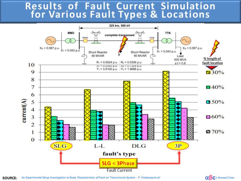

There is not a universal rule of thumb to determine the SC of SLG/LLL. All depends on multiple factors such as the location of the fault, transformer connections, system configuration, etc. However, If the sequence impedances data is available, the worst short circuit LLL, SLG or LL fault could be estimated by the curve below. Should be noted that 3 phase fault it is the usual the largest value.

Looking at the graph....Is the outer edge curved line forming the boundary of the area of the greatest 3-phase fault? Say Z2/Z1 = 0.9 not 0.5 as shown, and Z2/Z0 = 0.65 as shown...then the 3-phase fault is the highest number?

Please help us to reconcile the disagreement witch fault is the most severe between SLG and 3Phase fault.
>>>>>>>>>>>>>>> [highlight #FCE94F](3PhaseFault = V/Z1) < ? (SLGfault = = 1.5*V/Z1)[/highlight] <<<<<<<<<<<
Below are an illustration and a couple of links indicating that the most severe fault is the 3 phase fault for most cases. However, there are cases where the SLG fault is larger than the 3Phase fault.

Close to solidly grounded delta-wye transformers the magnitude of a SLG fault will be greater than the magnitude of a 3LG fault. Z0 won’t actually be zero but it will be noticeably lower than Z1 or Z2. Moving away from the transformer Z0 increases much quicker than Z1 and Z2. Once Z1 + Z2 + Z0 exceeds 3*Z1 the magnitude of a 3LG fault will exceed the magnitude of a SLG fault.

HamburgerH: Thanks for your fast response. I will guess that we may be in agreement that SLG varies possible in a range 0< ISLG < 1.5I3∅ depending upon the system grounded (Zero sequences and the impedance of the ground return path of the fault current.
