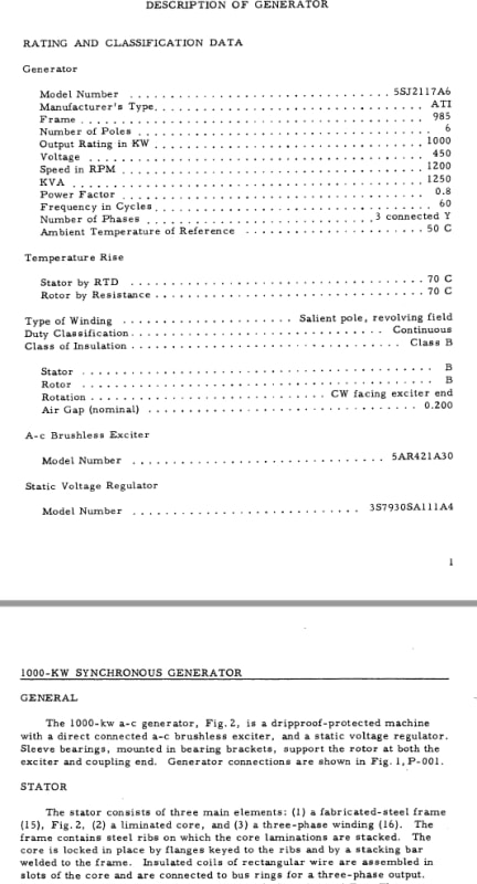

Checking the archives I see several entries that makes sense - however, does not cleanly map to my circumstance. I am looking to parallel to a old (~1965) GE 480V, 3 phase, 6 pole, 1200 rpm generator. The stator shows 108 slots and a pole covers 14 slots. From what is written, the pitch is 14/(108/6)= 14/18 = .778 pitch or 7/9. I expected to come up with a standard value of either of 2/3, 4/5, 5/6
Nothing in the manual regarding pitch
Could it truly be 7/9?
I would use 5/6 to eliminate 5th & 7th harmonics but I guess 7/9 is ok too. Are you sure you counted the pitch correctly? The difference is only one slot.

Thanks for the responses. Yes, the numbers have been counted correctly (checked twice). It is a shipboard ship-service generator driven by a steam plant (original SSTG plant aboard a resurrected T5 tanker.) It is 1 MW. I have access to the manual and will get that - however, the data appears to be generic, aside from what we know above.
Here is a screen capture of the specifications with model number if anyone can derive anything.
As far I know there is nothing such a "standard value of pitch" of double-layer winding for 3 phase electrical machine.
The pitch can be reduced, full or extended in order to meet the manufacturer's need.
BTW, the pitch value should be written as: pitch 1-14 or 1-15 instead of pitch 14, to avoid the misunderstanding.

Thank you everyone for your time and input. Another recount again yielded 14 and the number of slots covered by each pole, so 7/9 appears to be a solid number. Edison123's comment regarding only off by 1 (15 v 14) for 5/6 was a good path to explore, but the recount again resulted in 14. There does not appear to be a big difference between the two. Can a 5/6 parallel with a 7/9 for continuous operation, and are the regulating devices within their regions of operation such that a 5/6 || 7/9 mismatch can work?
Lots of installations out there with different pitch machines in parallel, a lot of " it depends" in a correct answer.
Are the units operating with neutrals connected or are the neutrals floating? If connected, how are they connected?
Are the units grounded or ungrounded?
What kind of loads are you supporting?
Rarely see an issue with differing pitch machines having any issues with their voltage regulators, but not unheard of. Ideally you'd want three phase sensing PMG type excitation systems. Also would be good to know how you are going to do VAR sharing, as different pitch machines VAR sharing in voltage droop or in Cross Current Compensation sometimes won't play nice together no matter what you try, but load sharing systems with active VAR share controls seem to do better, at least in the systems I have worked with.
MikeL.
BlackJackJaques
Controlling circulating currents when paralleling generators that shares same neutral is important. Paralleling generators with different winding pitch could lead to circulating currents in a common neutral power system which in turn lead to overheat the winding and false operation of over-current protection.
Hence, triple harmonic can be avoided by a 2/3rd pitch winding (may boost the 5th and 7th) and as Muthu say, the 5th and 7th voltage harmonics can be suppressed by 5/6th pitch winding (may boost triple harmonics (third, ninth etc.)) there are other factors to consider. In 2/3rd pitch generators the zero sequence value can increase the single-phase fault current.
For low voltage machines and a 3-phase 4 wires system, at least one manufacturer consider the best option is to use a 2/3 er pitch winding. When considering a winding pitch change consider that pitch winding change will impact the effective turns/coil of the winding which in turn impacts all flux densities, so it is strongly recommendable to verify and compare the new and actual winding data.
