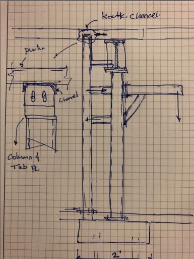

I'm looking at tossing a jib crane on an HSS post in a pre eng building. The post is unconventionally beefy for a pre eng building, and additionally there's been an addition built onto the long end of the building, essentially reducing my wind load in one direction, so I'm not concerned about the barcing capacity. What I am concerned about is getting the kick into the roof bracing - probably not prudent to rely on the torsional bracing to the purlins for this is it?
This can't be too clear, but a sketch is worth a million words.

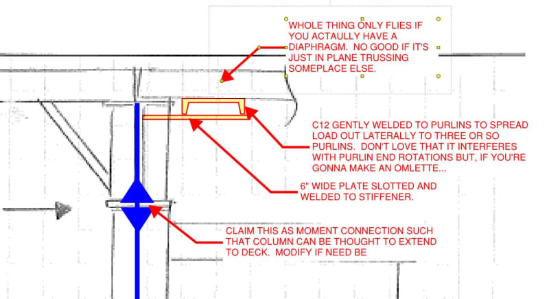

Can you do a completely independent vertical cantilever instead?

Kootk,
Not a bad idea, I was thinking of 30' beam from portal to portal with some bracing as a fall back but this is a little lighter.

Not a bad idea...
I'll just go ahead and assume that you meant to say "bloody brilliant idea...".
Whatever this, it sounds like the way to go to me.
canwesteng, apologies for the somewhat incoherent sketch, but maybe something like this could work - install a new post adjacent to the existing to take the lateral loads direct to the slab/purlins. You could use the kootk channel across a few purlins and attach the post to it with vertical slots.
