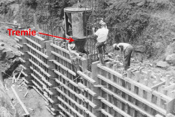

Thank you everyone for your responses the majority of you agreed that the concrete should be cleaned, the question is how do you pour a column or a wall and avoid concrete splatter on reinforcing steel? The contractor I am working with uses a large concrete bucket.

Use a "tremie" (large steel funnel with a long pipe attached to it). Keep the bottom of the pipe near (or even below) the surface of the fresh concrete as it is placed.

I have seen contractors build their own funnel using plywood and 2x4's if they are in a pinch. And when they get real desperate there is the old upside down traffic cone trick. lol

How do they prevent segregation? Looks like the fall is 2m before the concrete even reaches the top of the form, so around 5m to the bottom.
