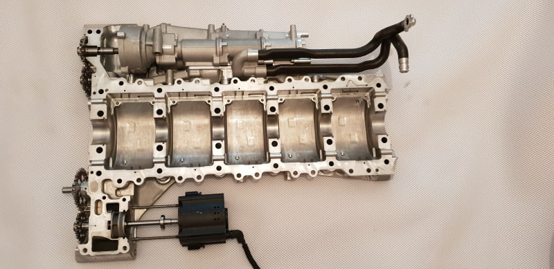

A somewhat sweeping statement, but I dont think it matters...and should still work fine - why...because on every inline 4 F1 engine I have seen each ''sump'' under its piston is separate and does not cross talk to its neighbor either - so a single cylinder as such.
You can see below on my V10 - they are separate too - although not the same as they share a bank, but same exact sump layout on the inline 4s..no comms to other cylinders, and one outlet to scavenge manifold per bank - one set of dedicated pumps/scav lobes per cylinder too.
HTH,
