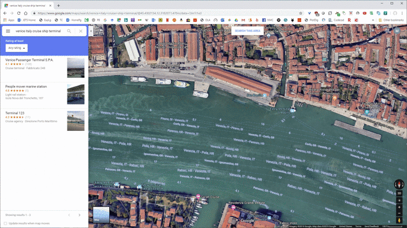

Finally found the spot. They were nowhere near their final destination, so probably not a tug problem, since they had nearly a mile before they were supposed to turn to starboard.
