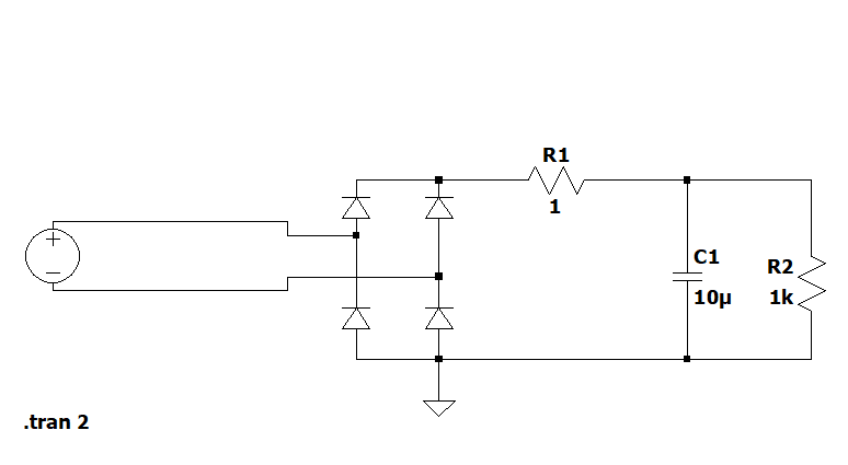

To make the scaled DC signal, I made a simple linear DC power supply circuit with no regulation. The AC is stepped down to about 4VAC through a transformer. The output AC is turned into DC with a full-wave bridge rectifier. Across the rectifier I have connected a 10uF capacitor and a 1k resistor. I believe this provides a DC output that will "follow" fluctuations in line-in AC voltage in a linear proportion.
I believe that aliasing is the problem because my digital multimeter gives readings that wander up and down, and I've hooked the circuit up to the datalogger and get the same result. Meanwhile the needle on my analog meter stays steady as a rock if I measure the same thing. The true RMS DMM readings wander up and down by 10%, so I do believe the sampling is the problem. Both the datalogger and the digital multimeter behave the same way. Simultaneous measurements of AC or DC voltage with my analog meter shows all steady. I can't change the sampling rate of the DMM or the datalogger.
I have already increased the capacitor from 1uF to 10uF with no measurable effect. Should I try more?
Is there a way to filter or smooth out enough of the ripple that I can limit the aliasing to 1% (0.05VDC)?
Is there a different circuit that will do what I want better than the linear power supply?

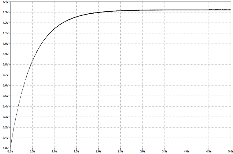

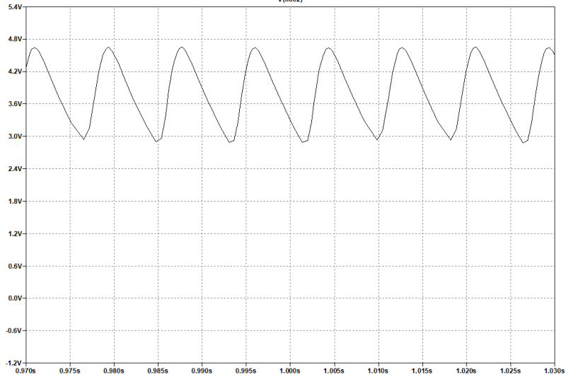

I ran a few LT Spice simulations and they show lots of problems with SW setup. Not to talk about those wave-forms shown. If the sine looks like a string of half arcs - there is a serious problem. That problem is more in the brain of the person that drew the wave-forms than IRL.
Original circuit:
And wave-form out:
There are soo many problems with that wave-form. Diode voltage drop, "impulse catcher" (diodes and naked capacitor does that, very high ripple because the time constant isn't enough. And then some - like temperature dependency and other things.
Increasing the capacitor alone doesn't help much. But if the source impedance into the filter is made fairly constant by adding a 1 k load across the bridge output, increasing the resistors to 10 and 10 k and going to 100 uF capacitor, you get a smooth output that doesn't show aliases:
Using 10+10 k will give you an effective Rout equal to 2.5 kohms and that only introduces an error around .25% - which drowns in all the other errors. It can, if needed, be easily be calibrated out of the recording.
