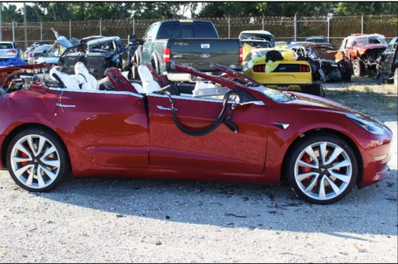

Behold... the new Tesla Convertible! 10
Spartan5
May 29, 2007
809
Three years later... same story:
Too early ... that was a fatality.
Tesla is still bragging that full self-driving is coming soon (they're suggesting this year, which presumably means 2019).
If they have thoughts of that happening in that timeframe, then their crash-avoidance / prevention ought to be near bulletproof well in advance of that date (so that they have time to validate it). Obviously, it's not.
Person driven vehicles do this most every day and for the same reason - the driver.

But, from the second link, the Tesla's algorithms are idiotic. The Tesla's algorithms have sufficient information to determine that the car cannot possibly fit under the incorrectly classified "overhead structure," even without a LIDAR. The computer had full information prior to the truck crossing the scene, and therefore, can easily determine that there's negative clearance. This is essentially the same kind of "here and now, ignore the past" processing that Uber's accident in Arizona, and the two Boeing Max accidents share.
