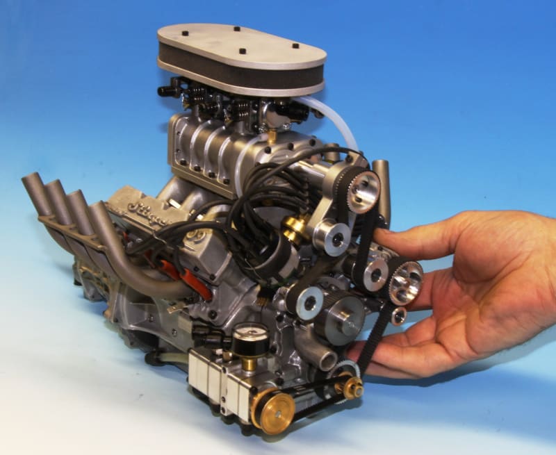

The Conley Stinger provides an interesting perspective on how long it takes an *individual* to produce a new engine design. The engine is a 6.09 ci V-8 producing about 5.5 HP normally aspirated and 9 HP supercharged. The designer/builder sells them commercially, and his "Update Sheets" chronicling the development go back to 2007. I'm pursuing a new engine design myself, and find it daunting even though I have long experience developing new products by the R&D team I used to lead. I've got three years into my engine and have yet to cut metal. I bet it will be at least seven more years before I have a prototype that works well enough to sell the approach to a company willing to refine and optimize the design for production.
