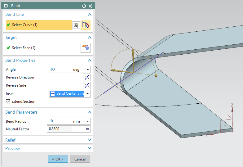

How would you model this?
I would try by wrap the two
Edges lines around the sloped
Cylinder
The two edges lines of the strip around the sloped cylinder in the angle shown.
Clarification.
Its 4 lines in 2 are in right angle
in the other 2.
Using the Sheet metal application, it's a "bend" feature. The centerline of the bend 45degrees and the bend angle 180 degrees.
Regards,
Tomas
I was thinking sheet metal was going to be the easiest option. Thank you for confirming Tomas!
Thank you,
Trent
NX 11.0.1.11
According the last post
I see that enough to wrap 2 edges.
Because the 2 others give the same
Wrap result.
