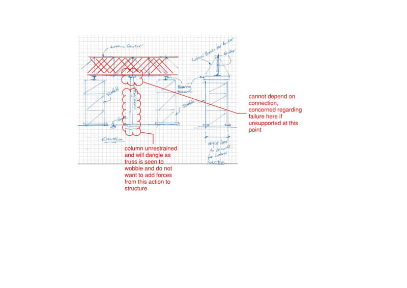

Hi All,
Looking for peoples thoughts on this - I have a line of existing cast iron column needing to be retaining on site but existing crap foundations need to be removed and replaced by new structure. The line of columns only hold a lattice girder, unloaded, just carrying it's own self weight. Three existing columns are circular, two are channels with plates connecting them vertically at 1200c/c and one column is a I section with rivits through both sides of the flanges. See attached. Note we are trying not to bolt through or cut any existing steel because we're concerned of the ductility of the cast iron. Columns are about 5m high. Cast-iron column will become a tension column with its own self weight in the temporary case until it is supported by new structure shortly after.
To do this, I came up with a tripod propping system, attached to the underside of the lattice girder around the truss via a temporary collar clamped tight around it and propped securely to a ground embedded pad foundation. The tripod props will carry the dead load of the girder and keep the truss from moving at the top. I have another collar mid-height of the column with a tie restraint beam back to the props to stop the column dangling and potential girder rotation once the existing foundation is cut out and removed. See attached. Does anyone have any advice or encountered any similar situation or should I specify any other safe measures?
So this works for the circular cast iron columns but for the other two, I'm stumped. Anyone any ideas how I can collar/clamp to an I section with rivits and a column made up of two channels/vertical plates @1200 centres and rivits? See attached. Have to clamp/support the column at the top to stop lattice girder moving and trying to avoid drilling.
Any comments gratefully appreciated!

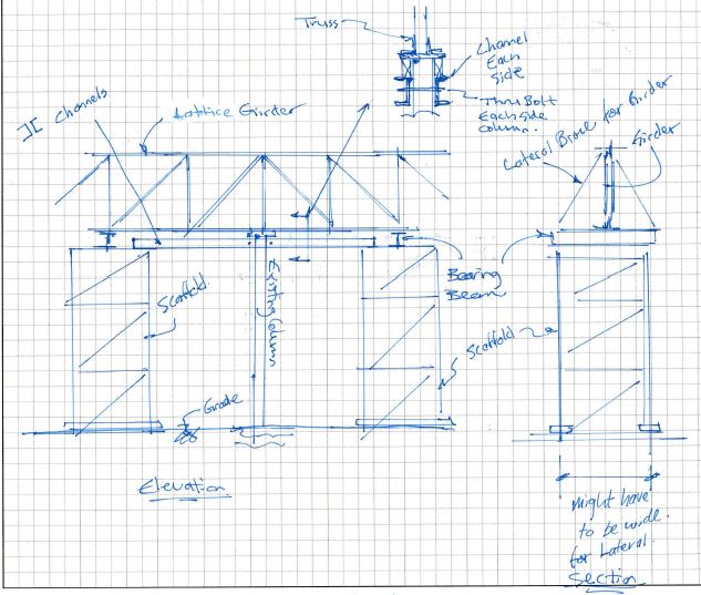

Any reason you can't just put in temporary columns, offset from the existing enough to get in the new foundations? Changes the support conditions of the truss, but if its just holding its own self-weight that shouldn't be an issue.
I think your current detail is unnecessarily complicated. Not saying it couldn't be made to work - but a few shoring posts (or shoring towers made of scaffold) would be much simpler, with much less potential for things to go wrong.
The existing columns and lattice girder has no lateral restraint at the moment until the building is in and has been noticed to wobble currently in high winds. Straps are keeping it from swaying at the moment so even if I prop the girder, I still have no rigidity from keeping this thing from swaying while we're cutting out the existing foundations and replacing new ones under a dangling column (which would rotate the girder further - does this make sense?

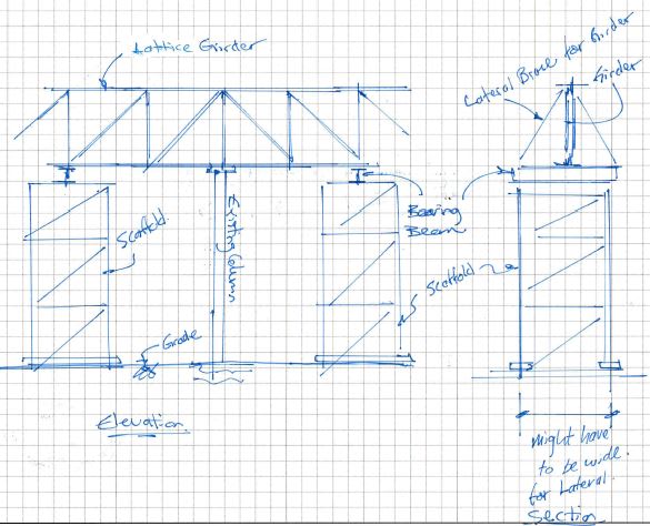

gmannix1000, see sketch below. Its easier to not rely on the column. I don't know what your loads are like, but you could likely do this with scaffold and a bit of custom steel for directly supporting the truss and bracing it laterally.

Thanks for that. Ideally, I would like to have done this. The lattice girder is in poor condition and many diagonals are missing as it is - 'hanging' the column from this is concerning and preventing the column from dangling or dropping away from the truss is the other concern.
I suppose we're just trying to mitigate any concerns with the tripod propping...
I guess I don't fully understand what you're intentions are. If you're putting a new footing under the column, I'm assuming you're putting the column and girder truss back into service. Won't the diagonals have to be fixed? And if you're missing diagonals near the column, even more reason not to support it from the column. If you put shoring towers either side, you can isolate the locations of the truss that are structurally deficient.
If you can't have the column suspended, that obviously needs to be addressed, but it doesn't have to complicate your shoring - which also needs to be done safely. See below for revised sketch - its rough, trying to eat breakfast at the same time.
Run a channel each side of column, spanning between shoring towers. Add a thru-bolt each side of column to wedge the column between the channels. Provide blocking tight to the underside of the column cap plate.
Build CanPro's scaffolds, add a collar close to middle of round column, span 2 small beams between scaffolds but under the collar, adjust 2 beams up to take weight of column and trap movement by adding 2 cross members between beams.
Canpro's suggestion is a typical method when renovating bridge girders at least for the company that I used to work for.
