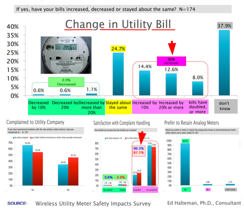

Smart Meter program is very controversial in the US.
Public Utility Commission (PUC) or the Board of Public Utilities in many states are facing the dilemma to authorize the smart meter program considering the unpopularity of those meters or restrict investment and job creation.
Although the many public complaints, PUC/BPUs are authorizing the deployment of Smart Meter projects promoting to implement capital investment on system modernization including "Smart Grid" programs.
A typical survey data is showing below:
1) Changing in Utility Bill: Decrease (2.3%), same(25%), Increase (35%), not opinion (37.9%).
2) Complains of Meter the performance : ~ 54% - 65% and 86%-87% unsatified with the action.
3) Customer preferences: Conventional analog meters (95%)

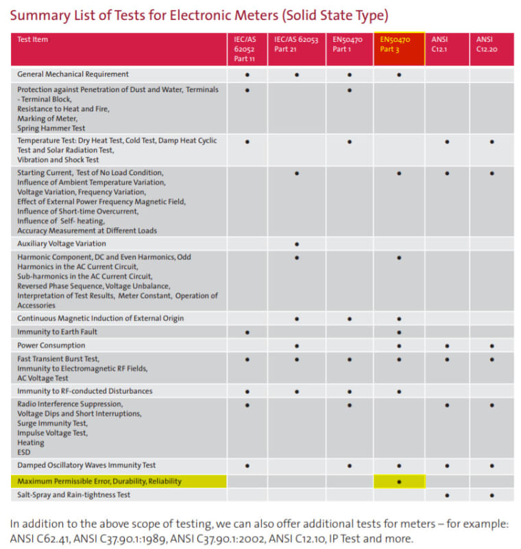

ANSI C12.1 applies to digital and electromechanical watthour meters, and specifies accuracy near the fundamental. Measurable inaccuracy for non-linear loads is mentioned and claimed to be under 2% in most cases. This is a case where the standard is a minimum. I think it is far more likely the electromechanical meters are filtering the harmonics out and the digital ones are measuring more accurately.
Early "smart" meters used a sensor to count disk revolutions. These were most likely to under-read, since the sensor could miss a count once in a while. Now digital meters are used with communication capability that directly read the registers. The digital meters can be purchased with and without communication, so don't confuse "smart" with digital.

In the US also smart meter should comply with UL 2735
As Stevenal say, ANSI C12 and also apply IEEE 2030.5 and IEC meter series for the accuracy and performance levels of electric meters;
and UL 2900 series for cybersecurity assessment.
Below is list of national and international standard for smart meters
