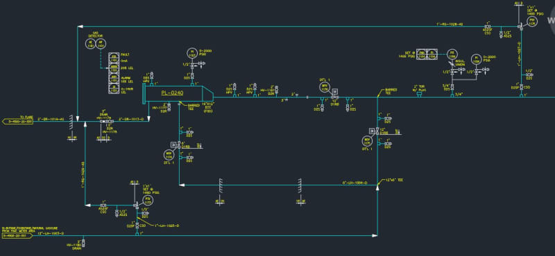

The current P&ID layout for the launcher is shown below. Still waiting on answers regarding the pigs themselves.

You really need have a pressure balance line from as close to the motorized valve as possible to somewhere on the major barrel.
On a launcher this is so that as you pressure up the trap, both sides of the pig ( which is jammed into the neck of the trap) pressure up at the same rate and have the same pressure. Otherwise your pig can start to move down inside the minor barrel and end up jammed against the valve. This is not good.
Just remember to close the balance line before you start to pig.....

Hmmm,
Unfortunately there is no standard for these items and you will see many and various ways to design them unfortunately.
However if you can explain why something is done a certain way then it hopefully makes sense to those who review and approve.
Also missed it first time around, but I've never seen a barred tee inside a pig trap before.
I realize this is for a launcher, but a 2" drain is quite small. It will take a long time to drain under gravity only and on a receiver could very easily become blocked with debris. Min 4" is much better.
Do you have a pressurizing loop somewhere? Just having a 6" valve on the kicker is a bit brutal when it comes to filling it.

I asked about the barred tee inside the pig trap, but they seem to have concerns that the pig could somehow get snagged a little in the branch without the barred tee. I also asked about the balancing lines and was told the intent is to hook up temporary connections to the 1" valves around the MOV's and balanace out the pressure that way. The company we're doing this for seems to try and keep all their pig traps in a similar layout to what you see below. I also don't really have much impact on the sizing of the 2" drain.

Hmmm,
Like I said there are as many different ways of doing this as there are pig traps, but this seems to be a particularly poor design.
Relying on make and break to install hoses and valves is not good practice and I can't quite work out how the drain line connects to the relief or vent lines?
Is this liquid or gas?
The barred tee thing is pure nonsense, how anything will get into a nozzle which is pouring gas or liquid into the trap is beyond me.
The equalization of pressure or filling with liquid across the pig is a key issue - how are they planning to do that?? Asking for the operations procedures might shed some light on it. Or asking a few operators.
I'm sure they will say "we've been doing it this way for xx centuries and it works fine", but that doesn't mean it is the safest and operationally correct way to do it.

From what I am told, the project consists of traps for liquid ethane, butane, and ngl lines. I think they're expecting the ethane and butane to flash when they open the valves. NGL they're still working out.
I agree with the barred tee issue. I don't understand their logic on that one. Especially when the pig should be getting shoved past the tee to the reducer to begin with.

Vaguely recall there is a max nozzle size limit beyond which a barred tee is required for piggable lines, but I dont recall it now. Could be DN100??. Agreed, we used to have a kicker line bypass for pressurisation purposes also. Where the pipeline is in 2phase operation with a slugcatcher downstream of the the pig receiver, a slug control valve is installed on the kicker bypass for slugcatcher level control. Obvioulsy, LTCS would be in order as MOC for these pig launchers / receivers for unstabilised NGL, ethane, propane. maybe not required for C4.
The usual ROT is 50% branch size to main line when you need a barred tee but I've never seen one on a pig trap before now.
