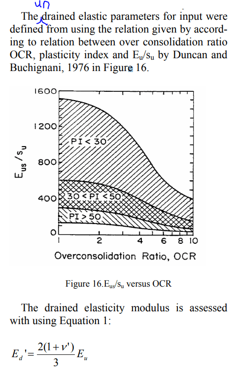

bdbd - see below. A method to derive drained youngs modulus from undrained modulus. I have never used it but stumbled across it now while looking for something else. I have corrected an error in the text, well at least i think its an error!
RE: Drained Modulus and Stroud Butler 1975
Thank you very much, but the main reason I am looking for a drained modulus correlation is to not use this elastic equation.
My bad bdbd! Carry on.....
Shub_123, although it is not exactly what I am looking for, it is very useful! Thanks!
