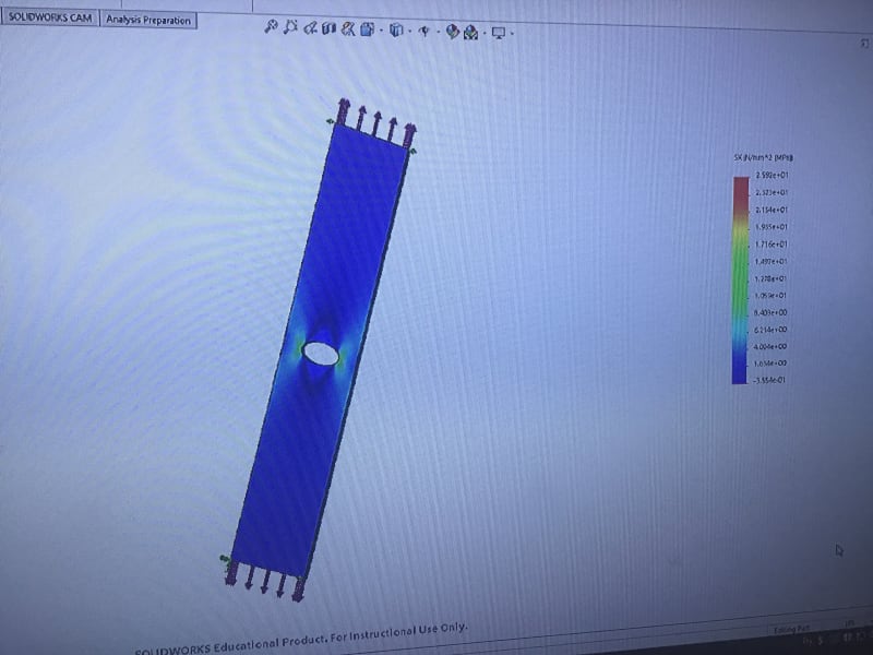

so technically there are constraints in the y and z direction. The face on the far left is fixed. FEA simulation is showing the following.
I’m not sure how to explain why there are sigmay stresses, or show what they should be in hand calcs

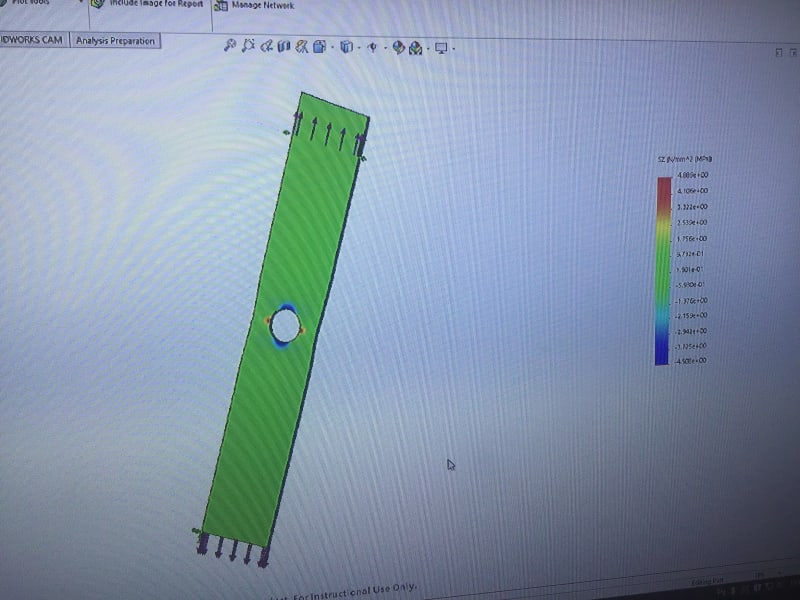

Thanks for your input ThomasH it is much appreciated. See below for the sigmaz and sigma x results. As you can see sigmaZ is fairly large actually

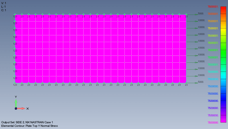

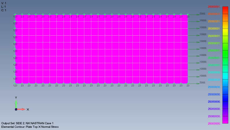

Remove the hole, add load on the short side (like you hve it now) and constrain in the perpendicular direction. You will obviously have stresses in x-direction sigma x = P / (100 mm * t).
You will also have stresses in the y-direction, sigma y = poissons ratio * sigma x. The same should apply for sigma z but that will not work if you use plate elements (plane stress means sigma z = 0).
The hole makes it more complicated to verify by a simple hand calculation.

A simple example: Plate 500 mm x 200 mm x 20 mm.
Load in x-dirextion: 100 kN gives sigma x = 100000/(0.2*0.02) = 25 MPa
Poissons ratio (steel) 0.3: sigma y = 0.3 * 25 = 7.5 MPa
Thomas

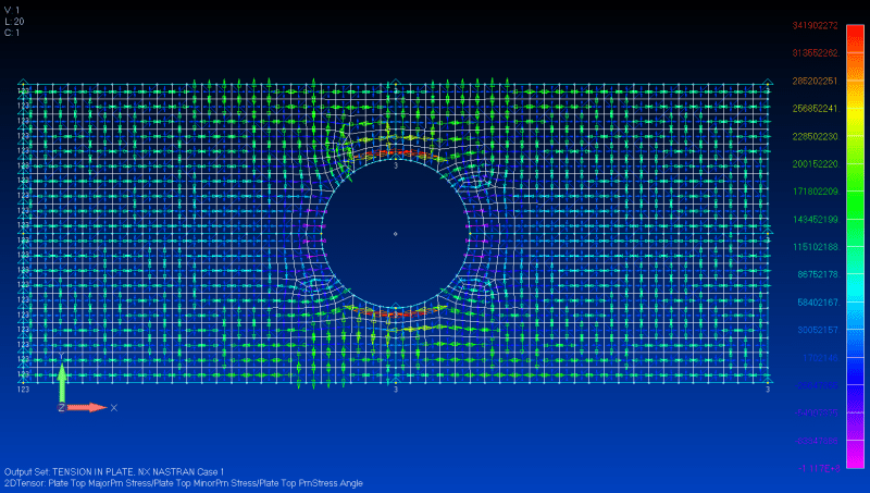

Below you see another figure. It is a platee with a 2d tensor plot showing the Major and Minor stresses with orientation.
At the left and right edge of the plate tha stresses are fairly uniform. In the middle they are definetly not uniform. But notice thar the stress near the hole (left and right edge) is small. That "stress" has moved sideways resulting in a sigma y component.
If you look at sigma y (not included here) the difference in results with Poisson = 0.3 and 0.0 is fairly small. That is as expected since the plate is not constrained in that direction.

My second example with vectors was intended to show why sigma y differs from zero. The stresses/forces has to "move" sideways which results in a sigma y component, this has little to do with Poisson effects. Hopefully not that hard to see either. It also shows that stress=force/area on the sides doesn't work. There will be effects due to excentricity.
