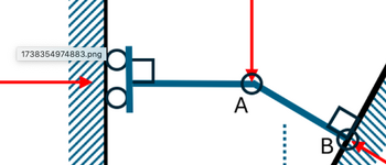

I am hoping to settle a debate between two engineers.
I have created a simple diagram of the part of the structure we are investigating.
It can be solved in 5 minutes or less by anyone familiar with static equilibrium problems.
The goal is simple enough: find Fn.
Yet, the discussion over whose solution was correct is still unresolved. I build a rig to physically measure it, but the disagreement persisted. Then I reached out to 5 university professors to see if they would help, but I have not heard a response. So here I am. Please help.

This is simply solvable by hand or computer in a variety of ways and the diagram given is obviously just a basic representation
Why are we arguing about whether the roller has one wheel or two???
one wheel means pinned
two means no directional restraint.
But having wheel of one and two is funny.
Anyway, by hand calculation, you can resolve it.
Point A provide only Rx.A
Point B provide both Rx.B and Ry.B
Solving for vertical force.
Thus, We know Ry.B is 5N because no vertical reaction at Ry.A
Solving for horizontal force.
Since the angle is 30° so we know the axial of the diagonal member is 5 / sin30 = 10N
Thus, the horizontal reaction Ry.B will be 8.6N
The Ry.A will be 8.6N as well, ignore the directional sign.
Thats why people says it is basic problem because we can get the internal force of this system
And we have someone solve this as shown

The picture I can see has a T shaped horizontal strut with TWO wheels between the vertical and the wall.
Hence it can react moments
What picture are you lot looking at?

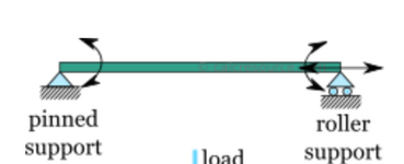

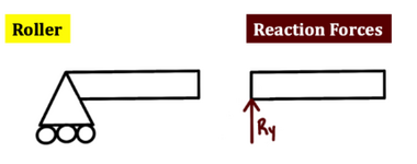

Greg, I'm assuming you're not particularly familiar with the symbols, but the number of wheels isn't generally indicative of two reactions. The question specifies one reaction Fx, there is no reason to believe it's multiple reactions. If the intent of the question was that there are two supports at that end, I would think it would be mentioned. The only purpose that vertical appears to be serving is to show the strut is perpendicular to the wall.
Representing a single reaction with multiple wheels very common, see below examples of a roller being drawn this way. It's not the only way, but it's common enough that it's the main notation I saw used throughout my education and have been using my whole working life.

It’s drawn in an unusual, rigid T-shape, which makes it easy to see why Greg interpreted the two wheels as separate rollers. Typically, rollers, despite being depicted with two wheels, include a small triangle seesaw, or pin to indicate that no moment can develop.

I think the conclusion is simple
LHS uses the standard roller convention i.e. there is Fx but M = 0 and Fy = 0
RHS is standard pin i.e. there is Fx & Fy but M = 0
Based on this, the maths is easily solvable as has been done already by hand and via SpaceGass
There is no debate on the reactions, axial forces etc

If A pinned , yes .. it will be unstable. The OP should clarify that , B is pinned and A is rigid .
If A is rigid, and B is pinned, the member collapses down. A has to be pinned in order to have horizontal forces. B has to be rigid or the system is unstable. After that it's making my brain hurt. Perhaps by realizing that the orientation of the support at B is irrelevant, we might gain some clarity.
You have quoted my first post. The debate was for the interpretation of roller support . The sketch provided by OP , shows horizontal reaction and almost all of the posters interpreted as roller support only . Then the OP clarified that , roller support has 90 degr angle and moment resistant. If this was expressed clearly at original post , the problem only 5 min. problem for an experienced eye. Still my interpretation is the same.
My points,
- If the roller support restrained only at horizontal , and A is pinned , the system will be label. This does not mean the system cannot resist the subject loading ,
- If the roller support restrained at horizontal and against rotation, there are 4 unknown reactions and with release of moment at A the system is determinate and stable ,
- If the roller support restrained only at horizontal , you need to add some restrain in order to make stable. This can be , joint A could be rigid , or support B could be fixed support.
