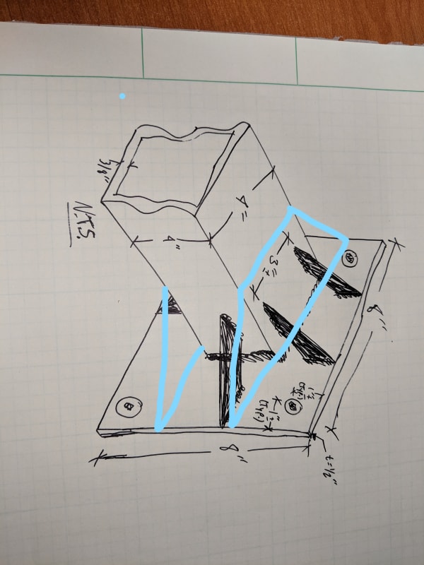

I can't for the life of me figure out how to correctly model and analyze this connection. I have a 4x4x3/8 square HSS tube with an 8x8xx1/2" plate fillet welded to the end.
This plate is then bolted at the corners to the main structure. I've attached a sketch.
Unstiffened, the plate is overstressed almost 200%, but I need to take the stiffeners into account. How can I figure this out?
 https://files.engineering.com/getfile.aspx?folder=fb63e05a-d5b5-48dc-8c87-5cb87e43caff&file=IMG_20190221_140503.jpg
Most efficient way of dealing with this would be to increase your plate thickness - slightly more material but your labor is essentially the same. Adding gussets will keep your plate thickness down, but now you have more material in the gussets and your labor just went way up. If you're 200% overstressed with a 1/2" plate, a 3/4" plate should do it.
If you need to go with stiffeners, I wouldn't arrange them as you have shown. If you weld to the face of the wall then you're attaching to a soft spot on the section and it will be inefficient. I suggest gussets as shown below. The bending in the plate becomes a simple check as well.

Totally agree with CANPRO, the stiffeners he shows would be a much better configuration. But, assuming you have to do it the other way.
1) RISA no longer sells it (because they want you to buy a more expensive program that isn't as good for base plates), but the old RISABase (if you can get hold of a copy) might do a good job of analyzing the base plate for you.
2) Then for analyzing the connection of the stiffeners to the side wall of the HSS, you should check out the Chapter 9 of AISC 15th edition. There's a section on plate elements subject to out of plane loads. Not your exactly situation, but you may be able to use it as a starting point.
3) In addition, the AISC design guide on vertical bracing connections (29?) has a design example with a gussett coming into the web of a wide flange. It uses similar yield line formulas to come up with the web's capacity to hand the force. Again, not your exact situation. But, between this and item 2 above, I imagine you can come up with something that's reasonable and conservative.

Ah so the stiffeners are already installed! You didn't mention that before...we're getting to the good stuff now. If you post a proper sketch of the baseplate showing the member size/location, stiffener size/location, and anchor size/location...along with some loads, you'll get more help.

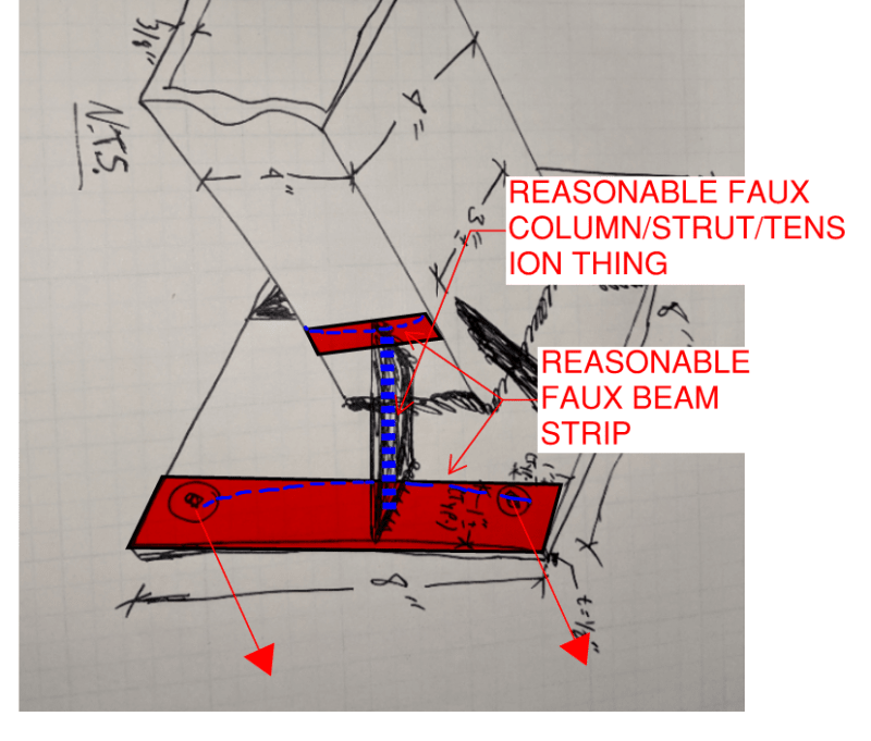

Based on the information given, I'd take the following approach:
[ul]
[li]start with the assumption that the plate/stiffeners are stiff enough to proportion the load equally to all anchors (if anchors/stiffeners equally placed)[/li]
[li]Use a yield line analysis or tables from Roark's if applicable, to check the plate in bending between nearest stiffeners/HSS[/li]
[li]after you evaluate the plate bending in various locations, you can revisit your assumption above. Yield line won't give you a deflection in the plate, but you can use your judgement based on how close you are to yield[/li]
[li]estimate the total load in each stiffener[/li]
[li]Treat the stiffener to HSS connection as a shear tab with axial/shear/moment and check using your favorite/governing HSS design reference. Options - > AISC DG 24, HSS Connection design guide by J.A. Packer and J.E. Henderson, CIDECT design guides. If you or any one else has anything to add to that list of references, I'd love to hear it.[/li]

kootk, in your "strip" method, do you have concerns about relative stiffness between the adjacent stiffeners? I like the method as a quick and dirty check, but I'd be inclined to neglect those side stiffeners all together. The stiffeners located on the corners of the HSS are much closer to the anchors, and stiffer...I'd assume they're doing a large majority of the work.
I do. But, out of practical necessity, steel connection design needs to be based on:
1) A rational, assumed load path that satisfies equilibrium and;
2) Hopefully no plausible, brittle failure modes along that path.
#2 usually winds up being at least partially BS but, alas, life must go on. Unless we're optimizing a "product", I try to stay away from FEM. It's labor intensive and given the uncertainties regarding substrate and anchor behavior, I rarely feel that the apparent precision is justified.
Fine by me. My approach in a non-product scenario would be to start with the simplest method requiring the least dubious assumptions and then work my way into more complex analyses only if required. I went a little astray here assuming that OP could handle the in-line stiffener business on her one and only needed help with the mid-wall stiffener scenario. Gotta watch those assumptions.
I see what you mean. I'd originally trusted in the to-scale-ness of the sketched but, reviewing the dimensions, I see that you're probably right. Regardless, I'd still start with your method for simplicity and then proceed to mine if I need to milk a little more out of it. Note that the distribution may be different when the base plate under the single stiffeners are in compression depending on the leveling nut situation etc.

The biggest concern about this particular connection I have is related to what everyone else has pointed out. Where those stiffeners connect to the approximate middle of the HSS. My thoughts on that.
4) The RISA model may do a decent job of predicting the maximum elastic stress at these points. Of course, this may end up being a little over conservative.
5) In addition, AISC Table K1.2 has a formula (K1-3 in the 14th edition) t_plate < Fu_HSS * t_HSS / Fy_plate. The idea is that you want plate to start yielding before it can rupture through the wall of the HSS.
6) I would do something similar to what KootK did for where the stiffener connects to the HSS. Meaning, I would use a representative length of the stiffener. However, I'd personally prefer to take the stiffener force and convert it into a shear and a tension on connection between the HSS wall and the representative stiffener length. Then I'd use the Table K1.2 equations to check it. That way, it's a little more code based and hopefully a little less conservative than KootK's method.
7) I'm not as concerned over the plate failure strip that KootK has in his drawing. Still worth checking. But, I'd say it's more like a fixed / fixed beam at each bolt location.... assuming that the bolts are fully tensioned and the design strip width isn't much bigger than the nuts / washers in that connection. Though I would want to check that the total reaction at each bolt isn't going to overcome the pre-tension.
