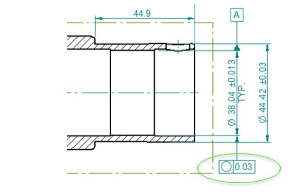

Hi, As you will see I'm no expert on GD&T but I have been involved in a discussion to try to reduce the number of concessions or scraped parts we produce as this has existed for many years as different manufacturing sites can interpret the drawing in different ways so the design intent isn't always clear. Some design offices ignore the 'rule' and allow a larger roundness tolerance than the size tolerance but other limit this to the max size control (which makes it harder to achieve!) and so we don't have a Standard practice across our design groups which is our ultimate aim.
A bit of history first so you know our issues. We produce mechanical seals and the sleeve component must comply to a very tight tolerance (API) over the pump shaft (typically F7 h6) so the bore size of our sleeve is often controlled to +/- 0.013mm. Controlling this size is not the issue but maintaining a reasonable roundness control is the problem. If I understand this correctly and if we follow the rules of GD&T (ANSI or ISO)the roundness tolerance cannot be > than the size tolerance so as in this example the roundness cannot exceed 0.013mm.
The actual components are typically quite thin (<4mm section) and are normally just turned (not ground) so manufacturing struggle to hold such tight tolerances. typically they can maintain a minimum of around 0.03mm tolerance on roundness so my question is: is it possible to apply an 'average' size control (as we know there is enough clearance between the shaft and the sleeve bore) and allow the roundness tolerance to be larger then the size tolerance (as per the attached)?
Appreciate any help or advice you guys can offer

This comes down to a question what standard governs the prints.
If it is ASME Y14.5, then by default Rule #1 controls roundness of a feature within the specified limits of size and any roundness tolerance greater than the size tolerance is redundant.
If it is ISO, then default rule is indepedency of feature's size and form and the roundness tolerance can be greater than the size tolerance.

As I stated earlier we are following ISO rules for GD&T so want to know if we can legitimately have independent tolerance for size and form BUT allow a greater tolerance for form as the size tolerance is so tight (typically +/- 0.013)that we struggle to hold that for roundness using conventional CNC equipment. To achieve this we would need to grind which obviously we want to avoid for time and cost reasons. We know we have a reasonable clearance between our sleeve component and the customer shaft so can get away with a slightly more generous roundness value but don't want to break any GD&T laws.
AFAIK ISO doesn't depend on the Envelope Principle unless it is exactly specified. I believe this leaves the full roundness tolerance available regardless of feature size. To be sure you should have a copy of ISO 1101 and ISO 12181-1 & 2 at the relevant version.

You are following ISO, so the rules are different. In ISO there is no dependency between size and form of the feature of size in case of the callout you have shown, because the envelope requirement (known in ASME as Rule #1) is not default condition. This means that the roundness tolerance value can be greater than the size tolerance.
The callout you have wouldn't be legal if circle E modifier followed the size specification or if letter E was used somewhere near the drawing title block indicating that the envelope requirement was default for the drawing.
