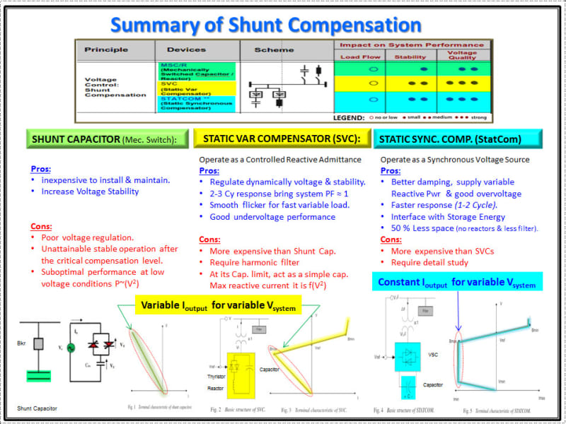

Significant improvement in power quality can be achieved using power electronic base switching technology better known as Flexible AC Transmission System (FACTS).
Below are pros & conns of shunt compensation applicable for HV systems.

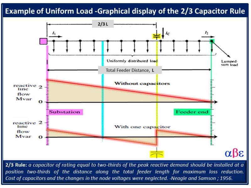

If I have a regular distribution feeder with low voltage and I use a capacitor to improve the voltage, where on the line would it have to for maximum utilisation and would it improve voltage for both customers before and after the location of the capacitor?
It depends!
Bill
"Why not the best?"
Jimmy Carter
The voltage rise is directly proportional to capacitor current and line reactance (see cuky's link), so it will be greatest at the end of the line. Yes, the voltage will rise for all customers even if the capacitors are not at the end.
You should also consider line losses. Capacitors will reduce line losses if they are located correctly. Line losses depend on total line current, not just the capacitor current. If you put the capacitors beyond the load, there will be more line current and losses in the line sections between the load and the capacitors. There is an optimum capacitor location along the line that depends on the load distribution along the line. Theoretically determining the optimum location is difficult. The best thing to do is model the circuit with a distribution analysis program and try different capacitor locations.
Although it is a standard utility practice to use capacitors for voltage compensation in MV and HV, It is uncommon for low voltage feeder regulation.
Due to the relatively short length of LV feeders, appears reasonable to consider the use of capacitors as close as possible of the inductive load (ex. large motors or Industrial load) and consider using alternate option to adjust the voltage such as using a buck-boost transformer, change the transformer tap, large feeder size, etc.
Below is a common practice used in general application in the power industry to locate the capacitor in a radial feeder:
