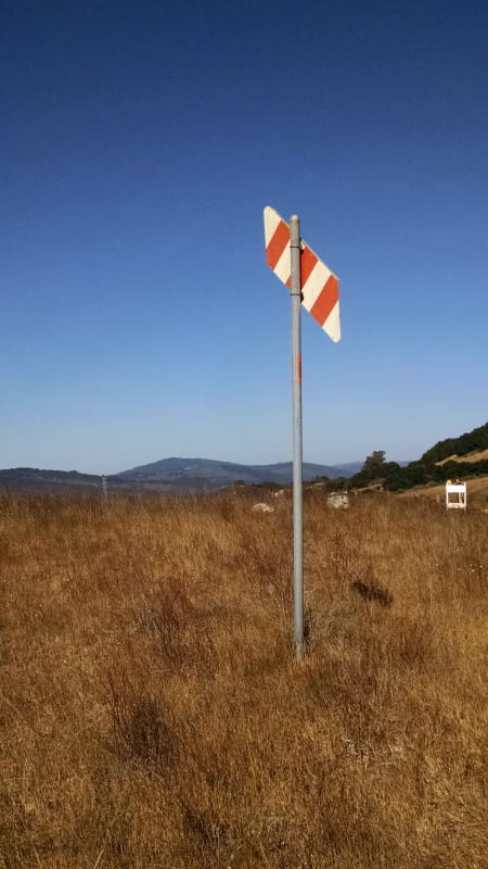

Scotty; It's probably one of those things where there are big
signs everywhere and so it's assumed when a USA call is made all the yokels show up to mark the lack of sewer lines and water pipes and maybe no one shows up to mark the 36" transmission line because, well, DUH, there are already signs. Problem is they don't actually say where the line is other than 'near by'. Then if someone digs by hand carefully and finds the line safely they know where it is and proceed to drill their hole. Unfortunately this doesn't work well if there are more transmission lines then one present.

Then again a 36" gas line maybe a transmission line, and the transmission company might not have been given notice to locate. That's likely why they place so many marker posts.
