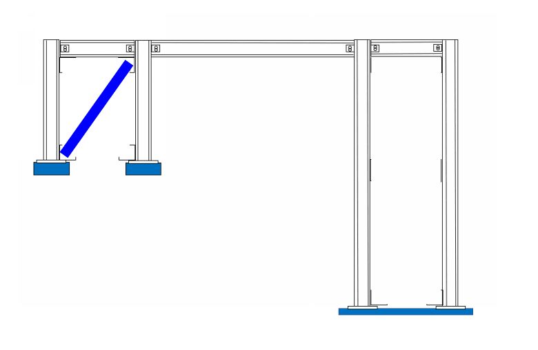

I have a three bay, rigid, plane frame that I am analyzing for a rolling 50 kip vertical load. The frame has pin connections at the base. I am trying to figure out how to analyze the three bay frame by hand, but have found very little technical literature on analyzing multi-bay frames other than by approximate analysis. I would like to use the slope-deflection method by splitting up the three bay frame into three simple, single bay frames. Can I separate each bay into its own single bay plane frame, and then superimpose loads similar to the approximate analysis methodology? I realize that I can model this very quickly in STAAD, but I am a new engineer and would like to understand and completely grasp how to perform this analysis by hand before modeling with software.
If instead I used a braced frame system with inverted chevron bracing, would I analyze as a truss system with pin connections, and then analyze with the force method for indeterminate trusses since I would have four external pin connections at the base?
I have attached a simple sketch to help visualize the frame.
Thank you!
would MDM help, to analyze the horizontal member (a beam on several supports) ?
It looks like all the joints (including the frame legs at the ground) are moment connections ?
Maybe use unit force ? Consider the end bay as a standard portal frame with some moment "leaking out" into the continuous horizontal beam. Then the flip-side of this is the portal frame being loaded by this moment, say 1000ft.lbs. And the same is happening at the other end bay (just opposite).
Or maybe this is the slope /deflection you were thinking of ... solve the end bay, how much does the RH joint rotate, calc moment to resist this, and iterate ?

For the design of the beam alone, I think that it would be pretty reasonable to just replace the columns with pin/rollers at the points along the beam where the columns tie in. If you wished to extend this, you could then assign the rotations at the tops of the columns to match the slope of the beam at the corresponding locations. This would give you design moments for the columns. All this would likely be as much effort as moment distribution (if not more) and would be less accurate.
Thanks all for your replies and suggestions. It looks like I need to learn the moment distribution method, and then apply it to the frame.
If instead I used an inverted chevron braced frame, what method would you suggest to determine the base reactions and axial forces? I assume I could analyze as a truss, but I read that you cannot the slope-deflection method or moment distribution to trusses, as there are no member moments. With all base connections pinned, I would have 8 unknown reactions and only 3 equations of equilibrium. I have used the force method for statically indeterminate, 1 degree trusses, but not for 5 degrees indeterminacy. Any suggestions?
Thank you all.
For Chevron, do a method of joints for the axial forces. Then use something like slope deflection or moment distribution to analyze to top member as a continuous beam, treating the Chevron joints as points of vertical support.

KootK - I have attached a sketch of the braced frame option. I opted to use inverted chevron bracing to avoid having the lateral braces take a substantial amount of load when the load location is at the beam mid-span, where the bracing would coincide. In the analysis, I placed the 50 kip load at the beam mid-span to design the beam. To design the column and lateral bracing, I placed the 50 kip load directly above one column and then applied a 2 kip lateral load to cover wind and rolling effects. This should give me the worst case loading for each element. I analyzed each "bay" by first finding the external reactions at the base using the force method, and then used the method of joints for the member forces. This seemed simple and straightforward enough, but I was curious as to whether I could isolate each bay in the analysis like I did, or if I had to look at the global structure as a whole to get more accurate results.

Thank you rb1957 for your reply. I agree, unit force method would be my preference also. The braced frame option seemed more straightforward to design, as the lateral load path was in the form of the lateral braces. I was looking into designing a moment frame to ease construction by not having to erect so much bracing, but the lateral load path wasn't as straight forward when using a moment resisting, three bay frame. This lead me to think that maybe I could separate each bay and apply the slope-deflection method, but after hearing all responses it seems like mdm is the way to go.

- Obviously, I don't know all of the constraints here but, at first blush, you seem rather over-braced. See my suggestion below.
- I think that a good strategy here would be for you to employ whatever approximate methods make sense to you and then compare those results to FEM output.
thx for sketch.
why not simplify the braced frames to a single diagonal ?
My thought process behind bracing each end bay: I plan to install a pad-eye on top of each end column, and use that as a pull-point to move the load along the frame. Since I am going to have a pull-point at each end, I thought it would be a good idea to have lateral bracing at each end. Is lateral bracing in one bay sufficient for this scenario? The lateral load would travel to the location of the diagonal brace, so that does make sense to just have diagonal bracing in one bay. I was just being conservative since it is a temporary structure installed for a large, moving load.

sure you can react the longitudinal load at both ends. Just more complicated, particularly given how different the ends are (the shorter one will be much stiffer than the long end).
I can see the logic for making a mid-bay pick-up for the chevron.
It's not really simple, but I have used a moment distribution for a frame in Excel and then automated it with a macro to get the reactions for various loading.
