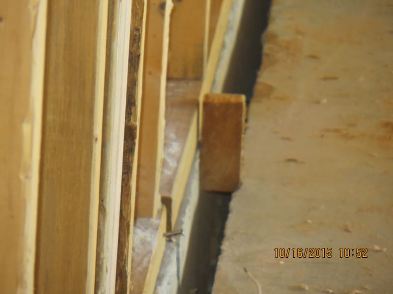

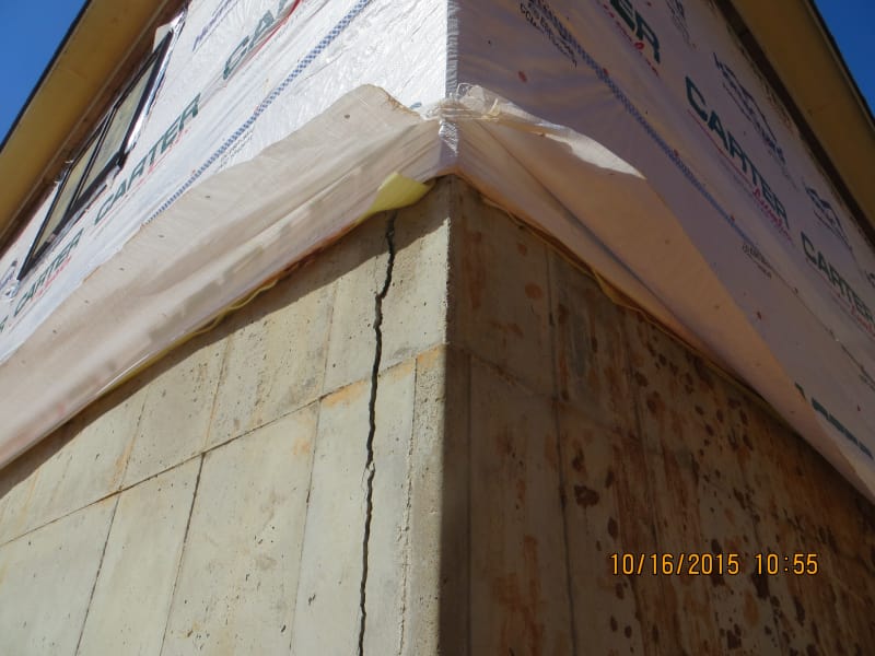

Check out these 2 pictures of an 11' one I did not design but had to look at the failure. This is an 8" thick "lightly" reinforced concrete one, but the contractor felt he did not need to tie the slab to the top of wall. Then he poured the slab but did not build the garage for weeks. Rain got into the fill. In one picture, that is a brick between the wall and slab. The footing is 2' wide with the wall in teh center of it

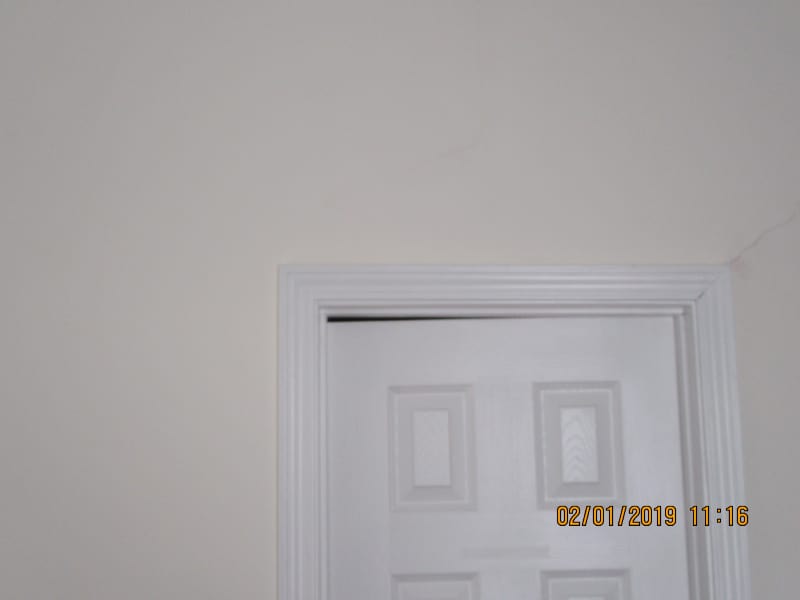

IFRS-you are correct. This is the bathroom door near the area being investigated. The door is fully closed in the picture. What contractors do is "sprinkle" the fill sand in rather than compact it. This gets them their paycheck. Some of them get the bucket as close as possible before they drop the load to minimize compaction. I had one "explain" to me how you successfully build one of these. Unfortunately , his was one we were reviewing that had a 2" depression across 10'
