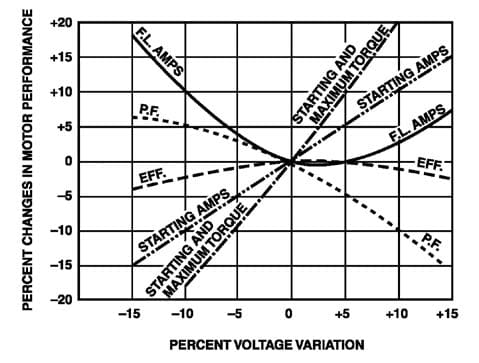

As the voltage drops, the torque drops. The motor slides further down the torque curve. That causes it to draw more current to try to maintain the HP demanded by the load.
It depends on the actual load which we don't know. The motor may draw less current, it may draw more current, it may stall.

The no-load current is higher due to the higher voltage.
The load current is higher due to the load. Your motor is mismatched for whatever load it is connected to.

My favorite chart when it comes to understanding that votlage variation in either direction can cause excessive current...
(Better version than originally posted)
